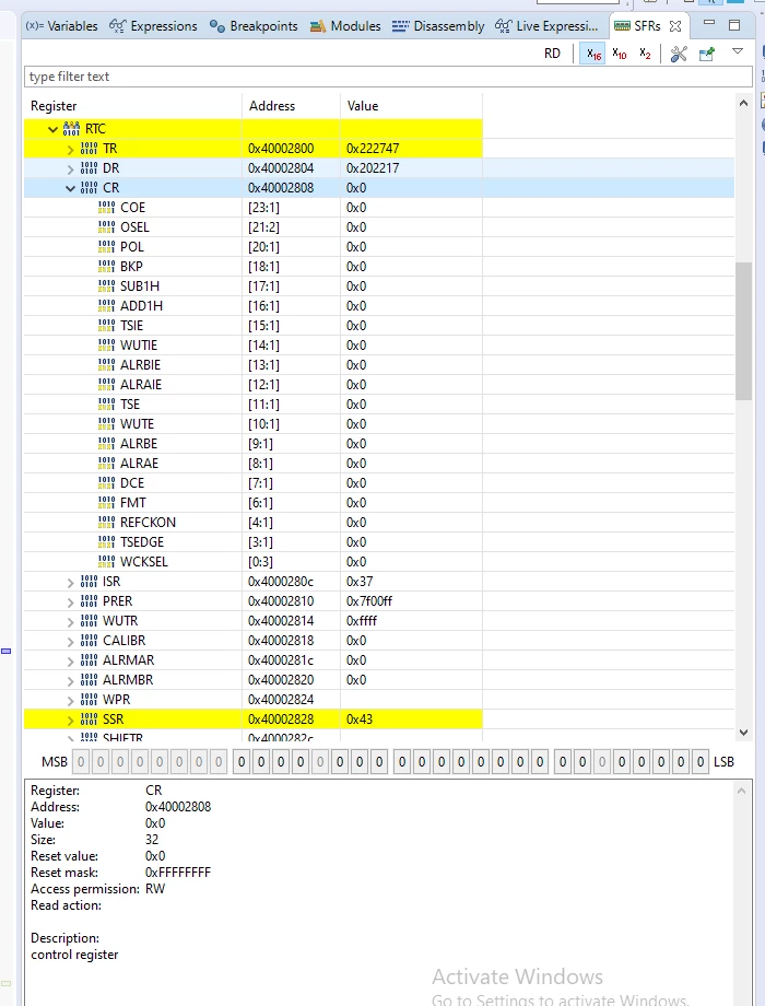

Reading continuously RTC in STM32F4 ar 180MHz
I have problems when I read continuously the RTC time in stm32f446 at 180MHz, after some readings, this gives me the same value. To find a solution, I implement a delay of 1 second to read the RTC and this solves the problem, however, I don't know what is the source of the issue. I am using HAL library for read the RTC.

waclawek.jan
Feb 17, 2020 5:05 PM UTC
How exactly?
Are you aware of the RTC_CR.BYPSHAD bit and that if it's cleared, you have to read RTC->DR after you've read RTC->TR? Read Reading the calendar chapter in RM.
Jefferson Cunalata
Feb 17, 2020 5:21 PM UTC
0690X00000DBjiCQAT.pngYes, I dont perform any change to RTC_CR.BYPSHAD bit so I suppose that this uses the deafult value which is cleared, however, I was looking to check this by using stm32ide with SFRs view tool, but the bit is not including here, however, the total register is showed and this effectivly is cleared. I attach the picture.
I am using the HAL library to get the time, so I assume it is correct. Here de code:

waclawek.jan
waclawek.janBest answer
Feb 17, 2020 7:56 PM UTC
OK, so
- set the BYPSHD bit when setting up the RTC, or
- always read date after reading time,
or do both.
Jefferson Cunalata
Feb 17, 2020 9:06 PM UTC
That is, I was just reading time without read date, now for each time reading operation I make read date operation and this solve the problen.
