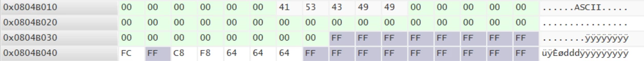

For example I have following contents in flash (shown from STM32CubeProgrammer):
Data starting at address 0x0804B040 (default values I stored) read as 0xFF. While data before this address as 0x41, 0x53 and etc.. is read correctly.
I tried to store defaults values even at the last blank page starting from address 0x0807F800, but also the same phenomenon - even I verify that it stored correctly - it is read as 0xFF.

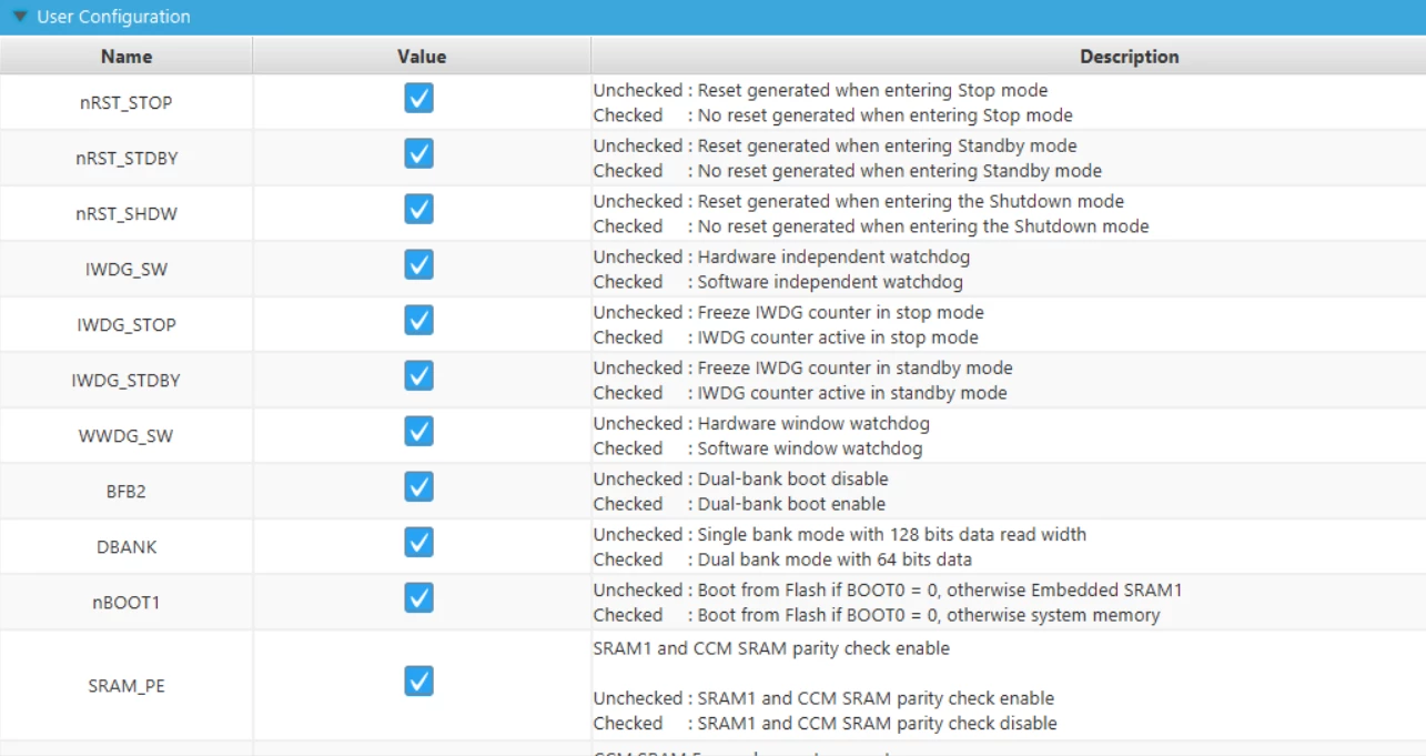

Can you show an equivalent dump from application space?
Is the application mapping the first or second bank?
Dump 0x0804B040 and 0x0800B040

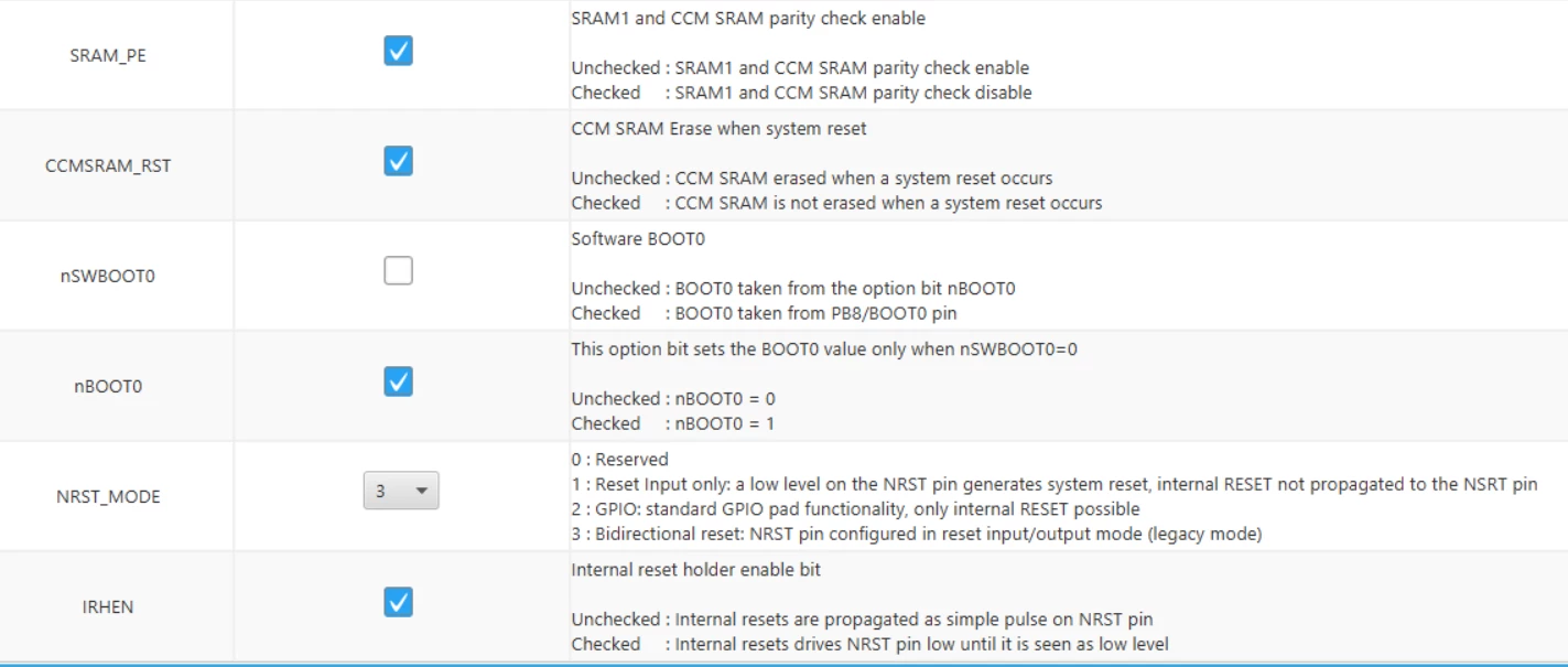

Dump FLASH_OPTR /  32-bit word at 0x1FFF7800

The dump of the correct programmed bytes:
I burn and verify these bytes (with during burning process from 'boot' image located at Bank 1 (0x8000000 starting address).

Dump of FLASH_OPTR:
