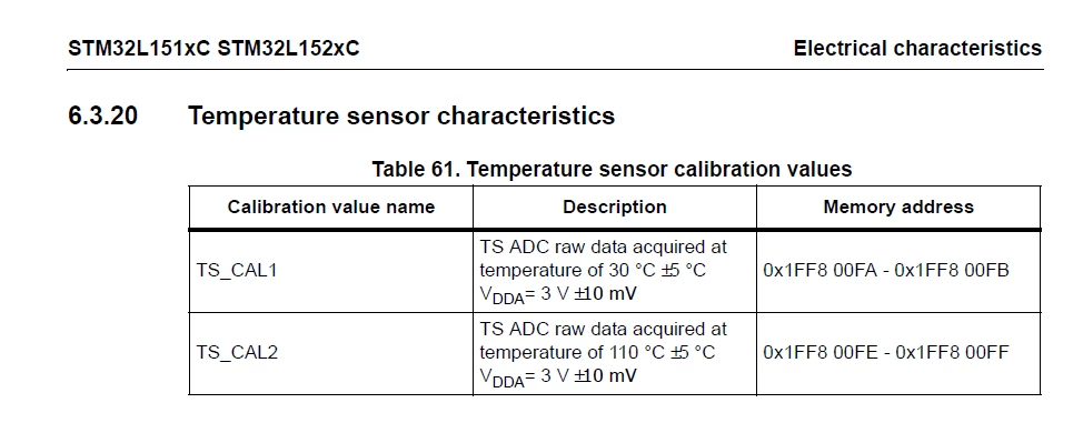

Read temperature calibration values from MC register
Steps to read the temperature calibration values from the stm32l152rc

uint16_t cal1, cal2;
cal1 = *(uint16_t*)TEMPSENSOR_CAL1_ADDR_CMSIS;
cal2 = *(uint16_t*)TEMPSENSOR_CAL2_ADDR_CMSIS;
TEMPSENSOR_CAL1_ADDR_CMSIS and TEMPSENSOR_CAL2_ADDR_CMSIS are defined in the CMSIS-mandated device header.

In the datasheet for your particular STM32 model, look up TS_CAL1 and TS_CAL2 addresses, and then read a halfword from that address.

Why is there two addresses corresponding to CAL1 and CAL2Screenshot 2023-10-19 135334.png

Each TS_CALx is 16-bit so it occupies two bytes.

Can I get an example souce code to read TS_CAL1 and TS_CAL2 addresses.
