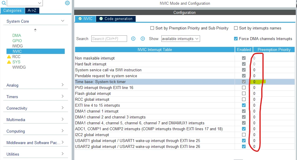

You can change the interrupt priorities for each interrupt. Right now they are all defaulted to 0.

I don't necessarily want to set the 1ms tick function to a higher priority than the audio routine. The audio processing is very runtime critical so having a fully independent timer variable I can simply reference would work a lot better.
I understand I could probably make the 1ms tick function just increment the global timer variable with no other processing, and do anything relying on the millisecond time base in the asynchronous loop, but this would be functionally the same as having a fully independent timer peripheral increment once per 1ms while also adding interrupt overhead to my program. Seems more ideal in the long term to set it up with the independent timer and not use an interrupt.

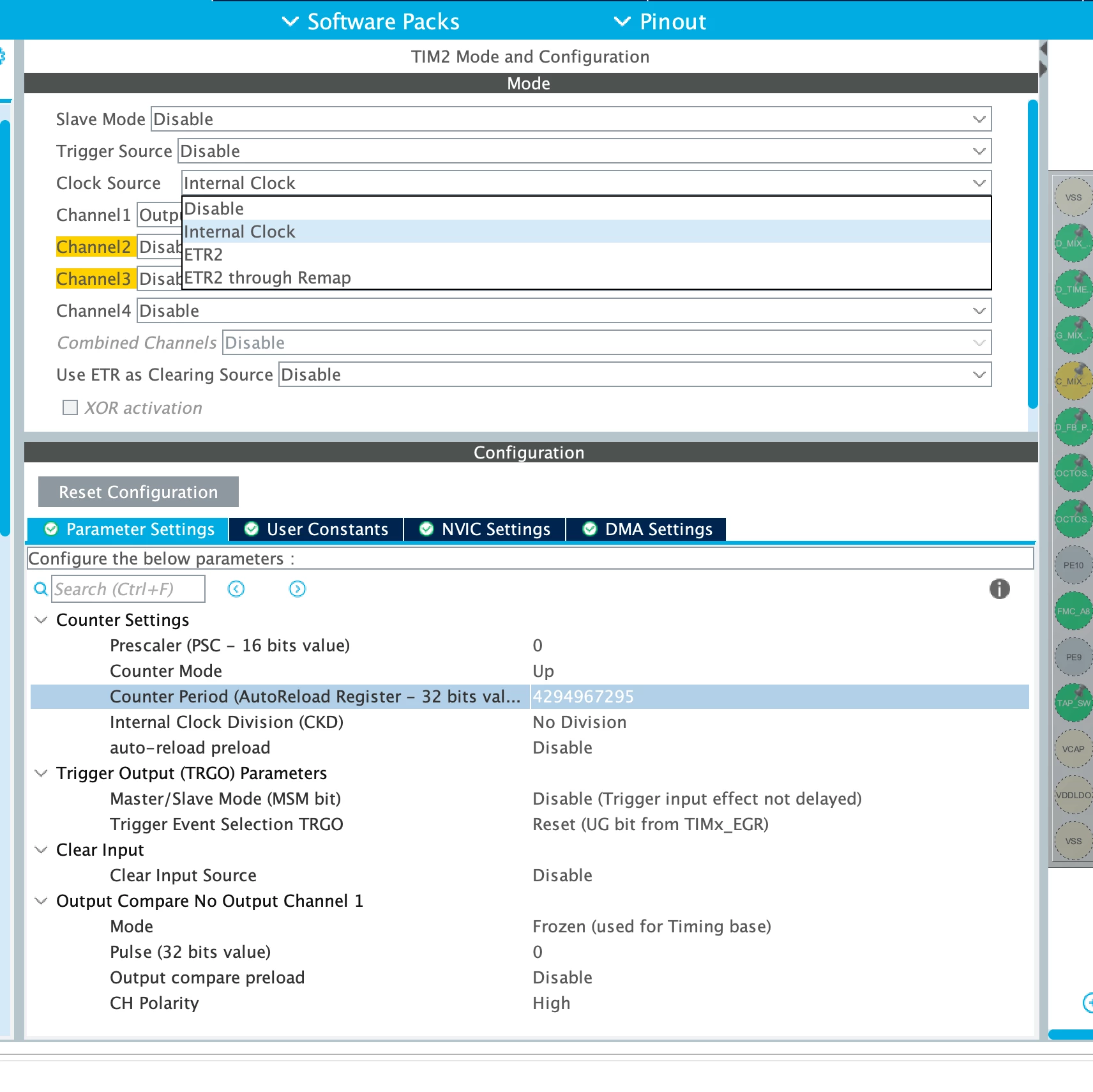

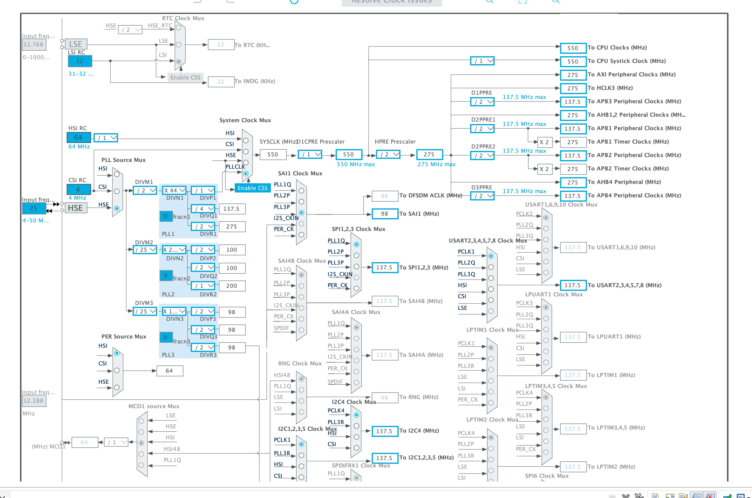

Is there an easy way to calculate the frequency or period of the timer? The options CubeMX gives for this are rather limited to say the least:
As you can see, I can select between 3 clock sources but there's no indication of what frequencies these are running at, also no indication of the eventual resulting frequency after the prescaler, the clock ui also makes it totally unclear which of the many internally generated clock values are being used as the "Internal Clock".
I also am unable to search for anything in the clock configuration tab, my only option is to squint at this super dense graph while looking for information that I don't even know will be there.

October 17, 2024
Are you able to share what the MX configuration for setting up a 1ms timer looks like?
As I stated in my last post, the MX UI is unfortunately not very intuitive for how to achieve this. It does not display a clear period or frequency value for the clock source or for the timer post prescaler.
Your screen shot shows the APBx as 275MHz. Simple math.
0.001(second) * 275MHz = 275000 (counter period).
275000 is within 4294967295 (32bit counter) so prescaler can stay at zero.
Auto-reload enabled, count down, NVIC enable, Update event.
