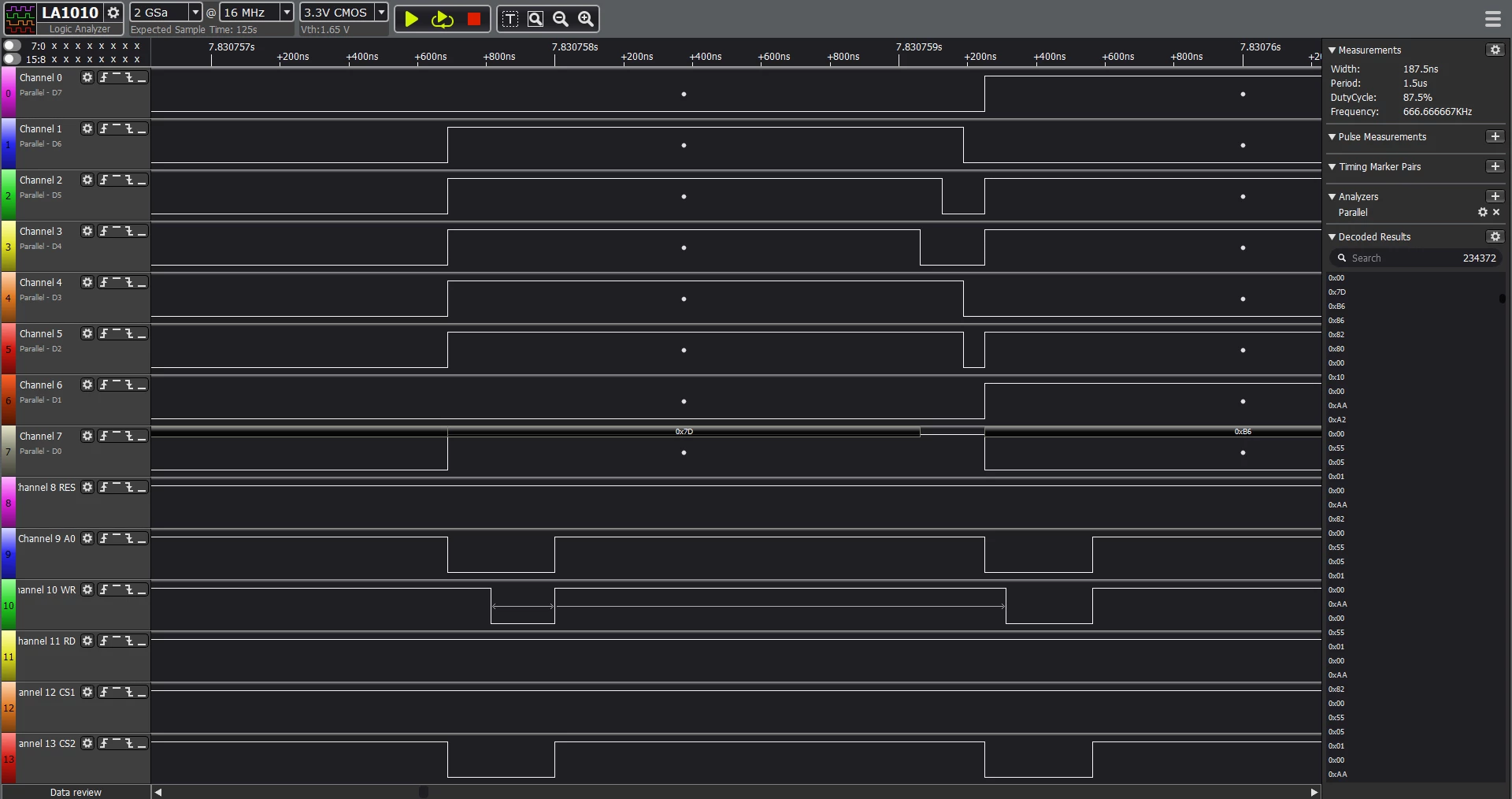

Hi, is it possible to connect STM32 instead of display and read its pins (A0, RD, WR, D0, D1, D2, D3, D4, D5, D6, D7) to know what device is sending and maybe replace original display with different display?

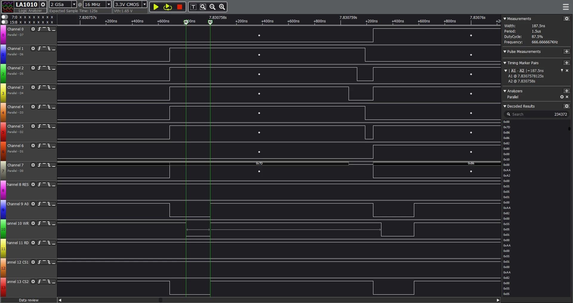

For example I would need to detect that WR pin went LOW and read all pins values at that moment in time. WR is LOW only for 187 nanoseconds. So is there any way to read this fast with STM32? How does display read that data so fast?
I have attached display commands which I have read with logic analyzer.
    Got logic gates and does it in HW, not SW perhaps?
    You could perhaps use latches so your response to an EXTI are less critical.
    For the write side you could perhaps use the WR as a TIMx_CHx input, that acts as a DMA trigger, and that reads all the pins on a GPIO bank via GPIOx->IDR ?

    Tesla DeLorean
    Guru
    Mar 19, 2020 9:40 PM UTC
    Well wouldn't be using a callback, that's going to add even more latency into the mix.
    You want to read the register as it enters the IRQHandler, and that's still going to have 12+ cycles.
    Ideally you'd latch all the critical data externally at the WR edge where it is valid.
    Perhaps a cheap CPLD? Or FIFO buffer?
    Read is going to be really difficult to meet the timing deadlines in SW.

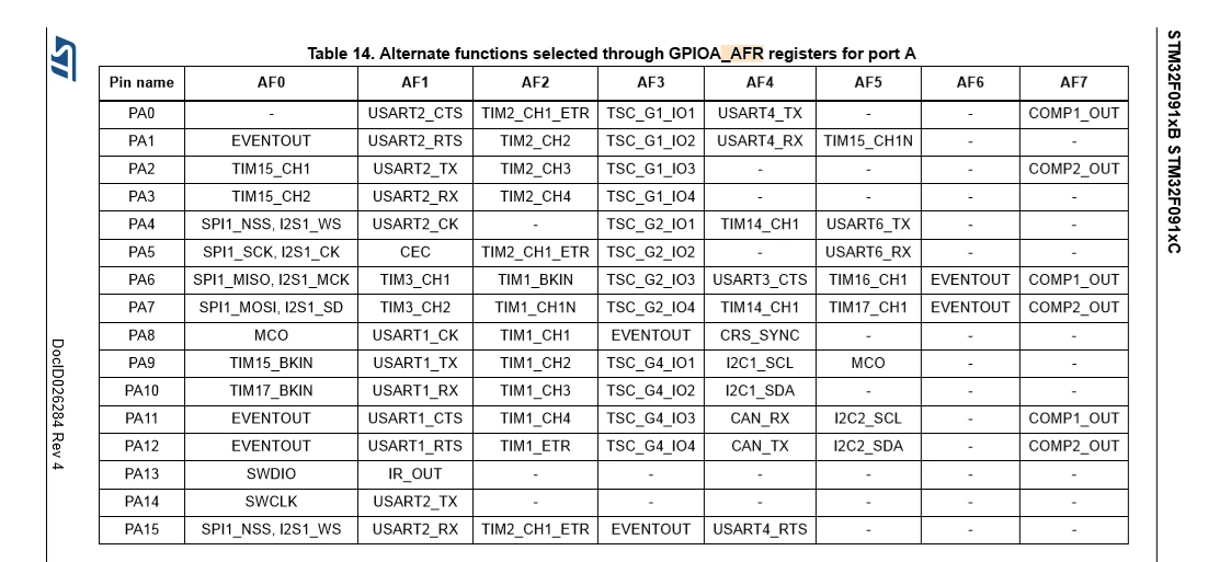

     // and the WR pin (PA0) as alternate function.
     // mapping PA0 to TIM2_CH1
     // AF number on your MCU datasheet:
     // Pin name AF0 AF1 AF2 ...
     // PA0 - USART2_CTS TIM2_CH1_ETR ...
     uint8_t AF_number = 0x2;
     GPIOA->MODER = (GPIOA->MODER & ~GPIO_MODER_MODER0) | GPIO_MODER_MODER0_1;
     GPIOA->AFR[0] = (GPIOA->AFR[0] & ~GPIO_AFRL_AFSEL0) | (AF_number << GPIO_AFRL_AFSEL0_Pos);

    I did read the reference manual or at least tried to, but its not really understandable easily. Also I find many PDFs and not even sure if I am looking at correct table.
    Is it correct table and I need AF2?
    You mentioned TIM2_CH1, but all I can find is TIM2_CH1_ETR?
    As I understand from reading you post more times the problem is in this line:
    GPIOA->AFR[0] = (GPIOA->AFR[0] & ~GPIO_AFRL_AFSEL0) | (1u << GPIO_AFRL_AFSEL0_Pos);
    //Note that AFRL corresponds to AFR[0], and AFRH to AFR[1].
    So I tried to think how to fix it:
    Select AF2 on PA0 in AFRL for TIM2_CH1_ETR
    AF2=0x02
    PA0=GPIO_AFRL_AFRL0_Pos
    AFRL=AFR[0] (because if want to use 0-7 PINS)?
    AFRH=AFR[1] (because if want to use 8-15 PINS)?
    GPIOA->AFR[0] |= 0x02 << GPIO_AFRL_AFRL0_Pos;
    Is it correct?
