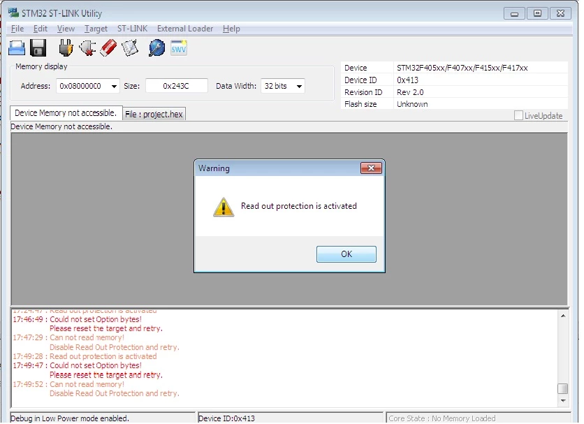

hello
Working on
https://community.st.com/tags♯/?tags=stm32f4discovery%20stm32f4
Discovery Board, it was working fine but now whenever i erase or try to upload a code it say 'Read Protection is Activated',So how to remove this.
After searching online tried this target->option bytes-> it shows level protection 1, made it 0 and clicked apply but gives an error 'Could not set Option Bytes Please reset the target and retry'.
Also tried boot0 to 3v and then erasing but it also doesn't work
Any idea how to get it out of read mode or wasy to reset it.
Thanks
