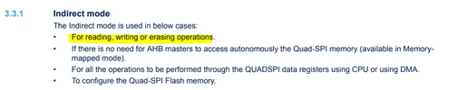

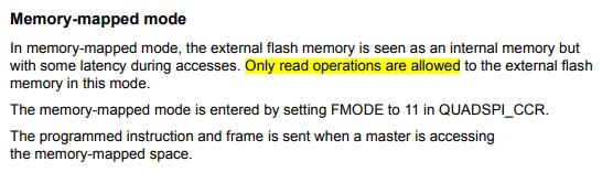

Hello @pxia.1 ,
For the QUADSPI interface, in memory-mapped mode, the external flash memory is seen as an internal memory but with some latency during accesses. Only read operations are allowed to the external flash memory in this mode. as mentioned in RM0440 section 20.3.11 QUADSPI use.
The indirect mode mode support read and write operations.
For more information I advise you to take a look at Quad-SPI interface on STM32 microcontrollers and microprocessors - Application note
So, for the QUADSPI interface, the write operation is not supported in memory mapped mode.
