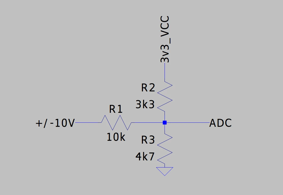

I have an ADC voltage ranging from +10V to -10V.
How can i read both the positive and negative value ranging from +10V to -10V on the same ADC pin.

MCUs can only measure voltages at their ADC pins that lie between the REF- and REF+ potentials. These potentials are always positive in relation to GND, which means that you can only measure positive voltages.
If you want to measure higher or even negative voltages, as in your case, you must first translate them into the detectable range, for which you can use opamps, voltage dividers or other suitable circuits.

If you use "standard" VDD = 3,3V and (3v3 = VDDA=vref+ ) , ADC can convert 0...3,3V ;
most simple solution is using a divider at input, + offset , like this:
But dont forget : do always "reference zero calibration" , because 0,0V input is about half of full scale at adc input.
So to get some +/- result, you have to do:   (adc_value) - (adc_value at 0 V input) = (+/- result)

Is there any calculation or formula for the solution that you have suggested for future reference.

The calculation can be done with Ohms Law and Kirchoffs Rules, the basic of any EE course.
