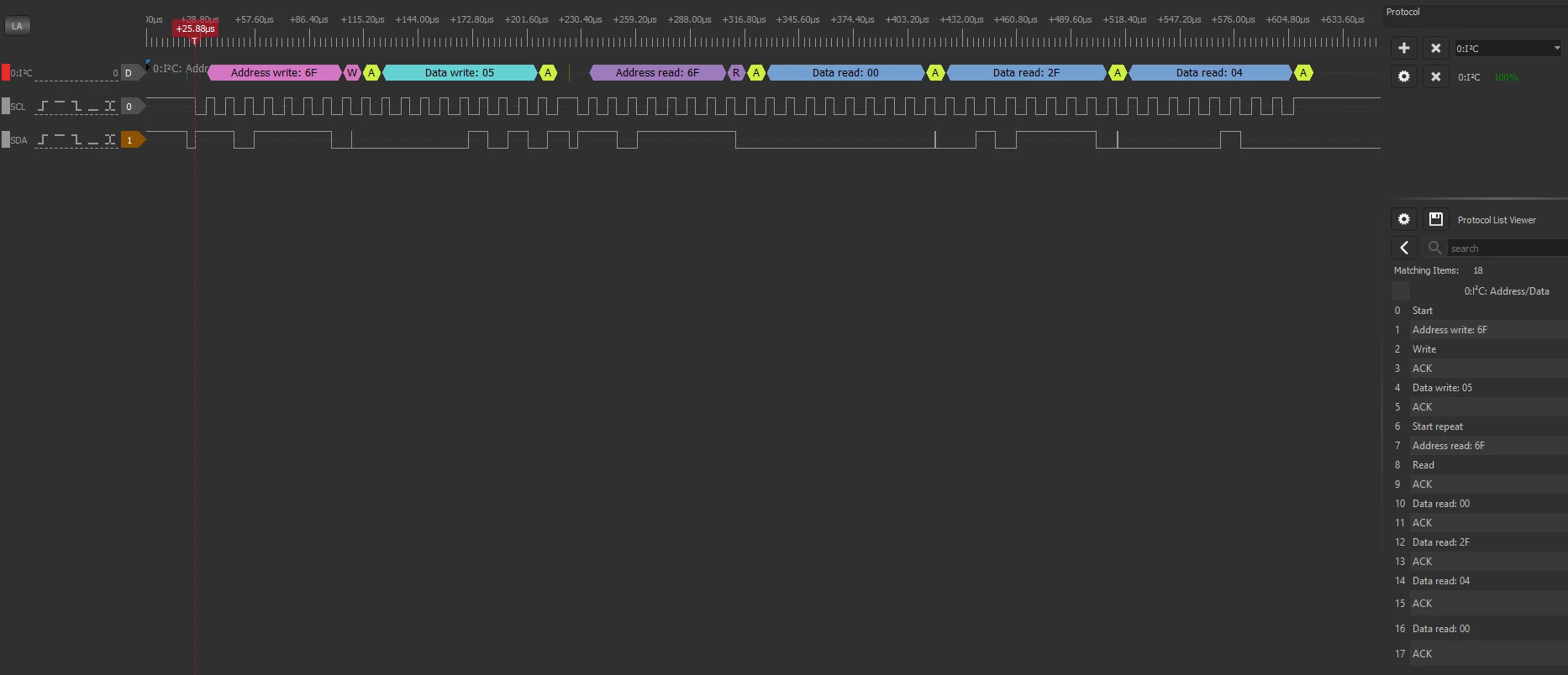

Helo friends.
Problem with write on I2C bus I solved.
If anyone wanted to, I would provide a solution
Now I have problem with reading.
I have got 1 stop bit more.
Here is good communication packet.
I receive:
   S-Address-W-A-Command-A-
P

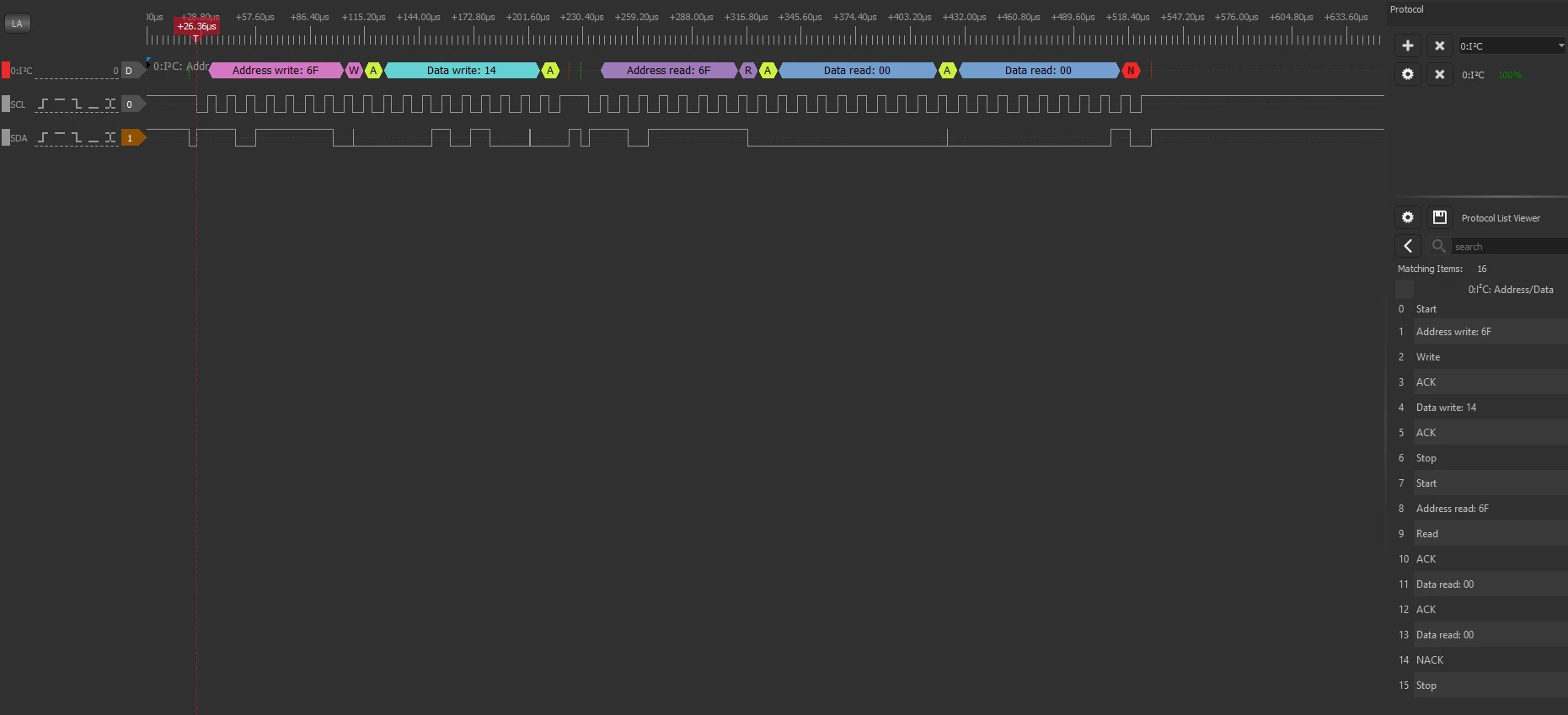

My call function:
uint8_t ltc[] = {0, 0, 0, 0};
I2C_read_brekeke(I2C4, 0x6F, 0x14, 2, ltc);   //address 0x6F; Reg 0x14, receive to ltc
In position 6 I have stop bit. It is wrong.
Any idea, what is wrong?

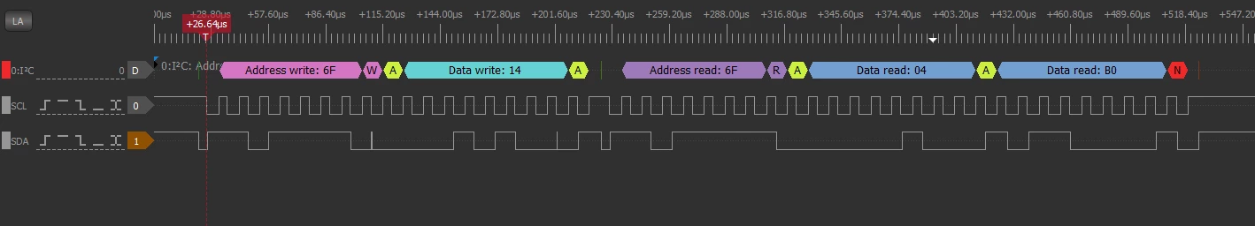

Pilous Droip
Senior
March 8, 2018
Posted on March 08, 2018 at 08:02
Hello friends.
This code working fine only for reading two byte.
But when I read 3 bytes I have big problem. I don't send stop bit:
uint8_t I2C_read_from_device(I2C_TypeDef *I2Cx, unsigned char Address, uint8_t reg, uint8_t nBytes, unsigned char *data)
   LL_I2C_SetSlaveAddr(I2Cx, (Address<<1)); /* Prepare Address to send */
   LL_I2C_SetMasterAddressingMode(I2Cx, LL_I2C_ADDRSLAVE_7BIT);
   LL_I2C_SetTransferRequest(I2Cx, LL_I2C_REQUEST_WRITE); /* Reguest write */
   LL_I2C_DisableAutoEndMode(I2Cx); /* Disable automatic STOP condition generation */
   LL_I2C_SetTransferSize(I2Cx, 1); /* Set transfer size register */
   while(LL_I2C_IsActiveFlag_BUSY(I2Cx)){} /* check I2C bussy */
   LL_I2C_GenerateStartCondition(I2Cx); /* generate I2C Start address and send address*/
   while(!LL_I2C_IsActiveFlag_TC(I2Cx)) /* check STOP bit */
      if(LL_I2C_IsActiveFlag_TXE(I2Cx))
         LL_I2C_TransmitData8(I2Cx, reg); /* send data out */
   LL_I2C_SetTransferRequest(I2Cx, LL_I2C_REQUEST_READ); /* Reguest write */
   LL_I2C_DisableAutoEndMode(I2Cx); /* Enable autoend mode*/
   LL_I2C_SetTransferSize(I2Cx, nBytes); /* Set transfer size register */
   /*while(LL_I2C_IsActiveFlag_BUSY(I2Cx)){} check I2C bussy */
   while(nBytes--)
      while(!LL_I2C_IsActiveFlag_RXNE(I2Cx)){};
      *data++ = LL_I2C_ReceiveData8(I2Cx); /* send data out */
   LL_I2C_GenerateStopCondition(I2Cx);
   LL_I2C_ClearFlag_TXE(I2Cx);
   LL_I2C_ClearFlag_STOP(I2Cx);
   return 0;
Any idea, what is wrong??

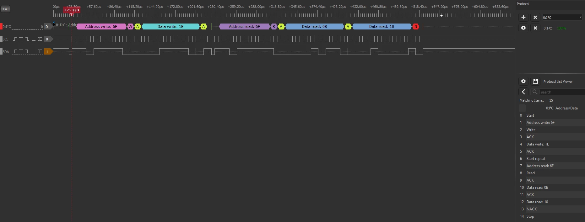

Pilous Droip
Senior
March 8, 2018
Posted on March 08, 2018 at 08:40
And now I try modificate the function, but the result is the same
   while(nBytes--)
      if (!nBytes)
         LL_I2C_AcknowledgeNextData(I2Cx, LL_I2C_NACK);
         while (!LL_I2C_IsActiveFlag_RXNE(I2Cx)){};
      else
         LL_I2C_AcknowledgeNextData(I2Cx, LL_I2C_ACK);
   LL_I2C_ClearFlag_OVR(I2Cx);
   LL_I2C_ClearFlag_NACK(I2Cx);
   return 0;

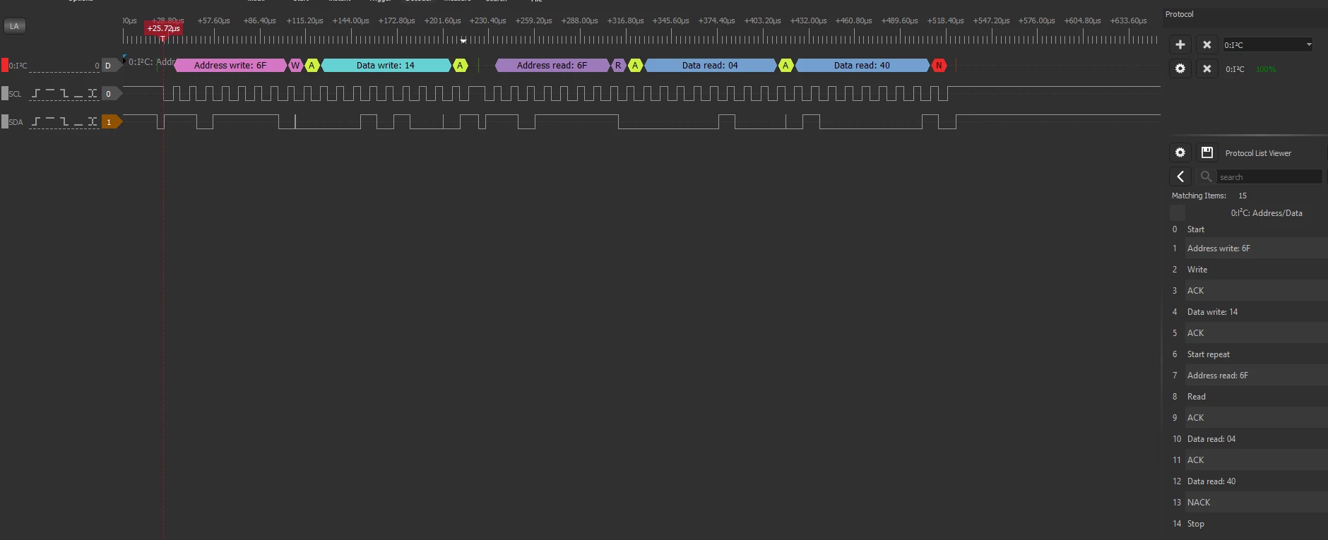

READ 2 bytes is good:

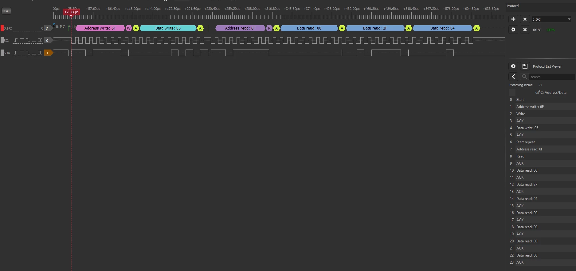

READ 3 bytes is bad:
waclawek.jan
March 8, 2018
Posted on March 08, 2018 at 11:14
Arbitration loss indicates that something is wrong with that last NAK (and the picture indecates the same).
Try decrease pullups on SDA, increase timing, and observe with oscilloscope.
