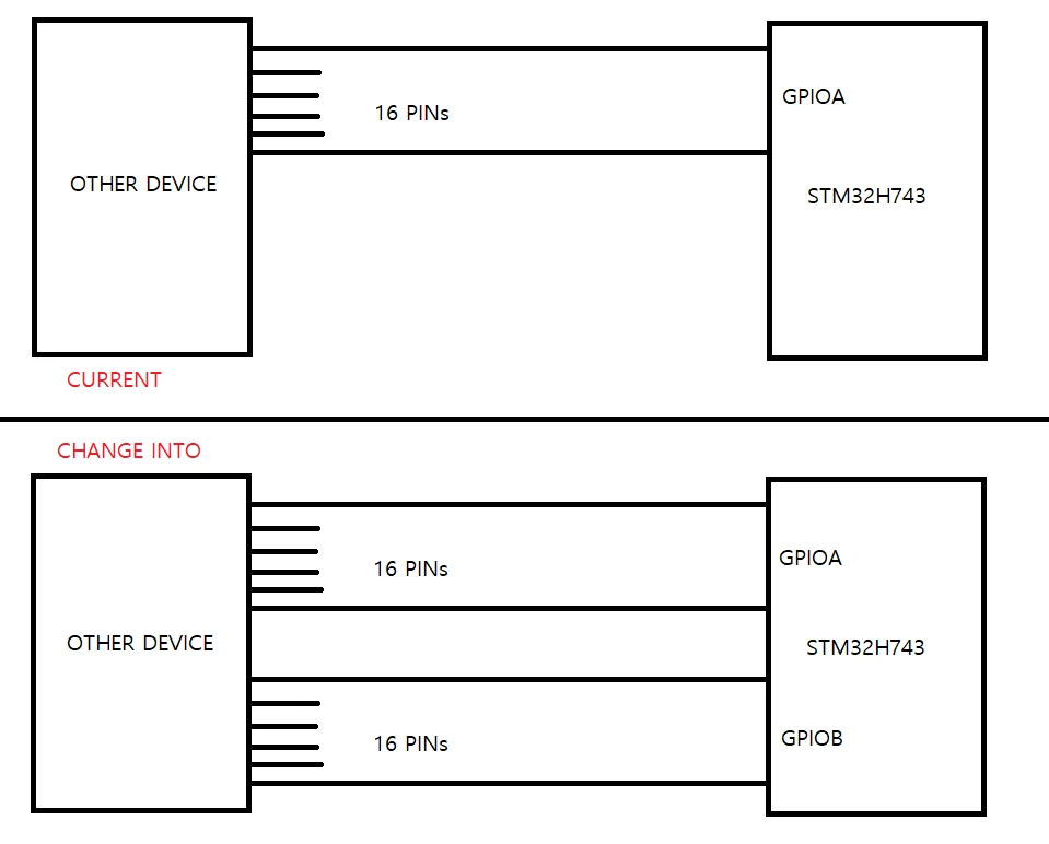

Read data in multiple GPIOx_IDR register / Combine GPIO Ports
Hi
I'm currently using STM32H743 and I'm trying to Read Data in multiple GPIOx_IDR register
Previously, I was using 16 bits and trying to change into 32 bits for IDR.
When I debug, I could find correct data on SFRs -> Register -> GPIOA -> GPIO_IDR with below code.
previous code
main.h
#define my_data_Pin (0xFFFF) // Use all PA0-PA15 pins
#define my_data_GPIO_Port GPIOA
otherfile.c
void read_my_data(uint16_t *pbuf)
*pbuf++ = (uint16_t)my_data_GPIO_Port -> IDR;
Now, I'm not sure how to define the code for using all PA0-PA15 pins & PB0-PB15 pins for 32bit data.
 0693W000006E7baQAC.pngI've tried something like below, but it didn't work.
#define my_data_Pin (0xFFFF) && (0xFFFF)
#define my_data_GPIO_Port GPIOA && GPIOB
Could somebody help me out with this please?
Your help will be highly appreciated.

You can read 32 bits at the same time, but only from a single location. You can't read 16 bits from location A and another 16 bits from location B simultaneously.

Nov 30, 2020 2:10 AM UTC
Since your array is of uint16_t, just do two operations:
*pbuf++ = GPIOA->IDR;
*pbuf++ = GPIOB->IDR;
The cast to (uint16_t) isn't hurting anything but it's not necessary.
This will require two operations. Trying to do something like GPIOA && GPIOB is nonsense.

I've tried that, but I want to make it happen simultaneously.
  1. *pbuf++ = GPIOA->IDR;
  2. *pbuf++ = GPIOB->IDR;
#2 is always late than #1.
Currently, I'm using uint32_t instead of uint16_t.

Nov 30, 2020 2:31 AM UTC
You can't do them at the same time. The CPU only does one instruction at a time. You could combine them into the same C statement, but it still won't occur at the same time.
*pbuf++ = (GPIOA->IDR << 16) + GPIOB->IDR;

oh... thank you so much for your help.
seems like reading 32bit data at the same time is impossible for STM32H7.
I'm trying BSRR instead of IDR to try 32 bit. However, the data only comes in through IDR register.
TDKBest answer
Nov 30, 2020 2:52 AM UTC
BSRR always reads as 0, don't see how that would help anything here.

The FMC could input 32-bit data in parallel on their data inputs, if the used package supports all 32 bits (probably >100 pins); but the latencies may be higher than with GPIO input.

How do you input data to FMC though?
Can't find alternative Ports other than GPIO Ports.
waclawek.jan
Dec 1, 2020 6:18 AM UTC
Set up FMC for SRAM and perform a read from that "SRAM". You don't need to actually assign pins to address and control lines.
