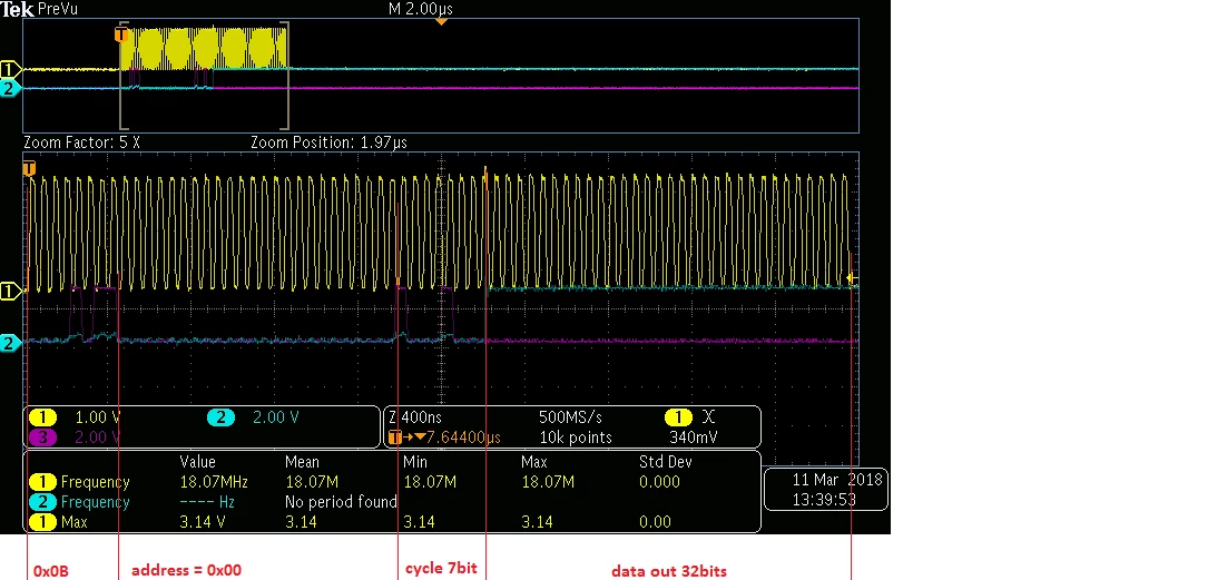

Hello.
I have a problem. I have this function:

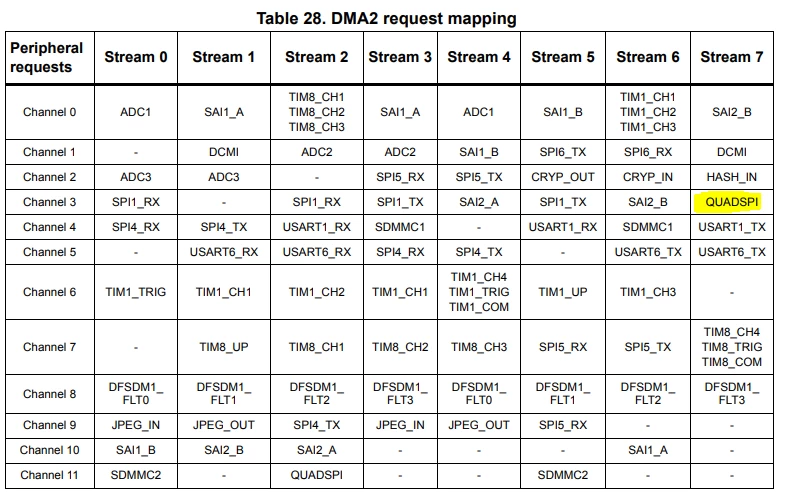

{ /* Quad Command Fast Read (QCFR), instruction, address, data use 2 lines * Adresa: 24 bits (3 bajty - viz QUADSPI_CCR_ABSIZ) * read: byte (count) * * Read with DMA, mez FIFO = 1 * DMA2, Stream 7, Channel 3 */ DMA_Stream_TypeDef *stream = DMA2_Stream7; LL_AHB1_GRP1_EnableClock(LL_AHB1_GRP1_PERIPH_DMA2); stream->CR = 0;stream->CR =

stream->CR |= DMA_SxCR_EN; QUADSPI->AR = addr; //write to address register, when ADMODE != 0 and FMODE = 1. while (!(DMA2->HISR & DMA_HISR_TCIF7)) {}; //wait to the end of DMA DMA2->HIFCR |= DMA_HIFCR_CTCIF7; stream->CR &= ~DMA_SxCR_EN; SCB_InvalidateDCache_by_Addr ((uint32_t*)dst, count); // reset cache QUADSPI->CR &= ~QUADSPI_CR_DMAEN; //the end read of DMA}And i have a problem with this line:
My program is waiting on 'while'. And I can't find a solution of this problem. Any idea, what is wrong?
But, I check the communication. And you can see,
- Fast command (1byte) 0x0B were send
- Address (3bytes) 0x00 were send
- dummy cycles (8bits) were send (but, here is anything wrong.....)
- Data received (32bits)
Do you see anything wrong?
