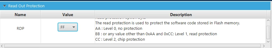

Hi I'm using STM32F411RET6 MCU.
I tried to connect using the programmer to download the firmware, but there was an error as shown below, and the data cannot be read.

After that, the firmware will not be downloaded, and the message core is locked up.
I checked that it was a problem related to RDP, and it was set to FF.
RDP cannot be set to another level.
How do you solve this problem?

Aug 20, 2025 12:46 PM UTC
If the chip is in RDP level 1, you will not be able to read the flash memory. A full chip reset is required in order to set it back to RDP level 0.
What happens when you select 0xAA for RDP and hit apply?
giwonKIMAuthor
Aug 20, 2025 11:46 PM UTC
If convert to 0xAA and press apply, you get an error that you cannot change it, and the value 0xFF is read again.
