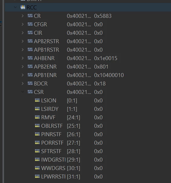

I am working on adding an IWDG to firmware on a STM32F070CBT6TR. The Watchdog resets perfectly fine. I cause the watchdog to reset the MCU by not resetting the timer. I then try to read the RCC_FLAG_IWDGRST and it is always 0. This is what my main looks like before trying to read the flag.

Try reading it immediately after main(). Try verifying the bit directly by looking at the the RCC_CSR register.

I am still not seeing my boolean set to true. I connected my device to STM32CubeProgrammer while my firmware was running and the register is also 0 there.

I added a breakpoint at line 4 and stepped over to complete the read. This is what the registers look like after IWDG resets the MCU:
Note that LSION and LSIRDY aren't set because I am stopping before IWDG is initialized again.

Something may be clearing those flags. One bit at least should always be set. Can you zip up your project and attach? You can set a breakpoint at Reset_Handler to catch it when it just resets.

Given non-reset-default AHBENR/APBxENR (enabled DMA, TIM1, I2C1, TIM6) I bet you have some custom bootloader running before the application.

You are absolutely right. I completely overlooked my bootloader. I will look into that.
