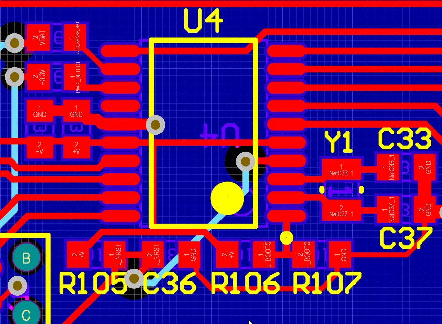

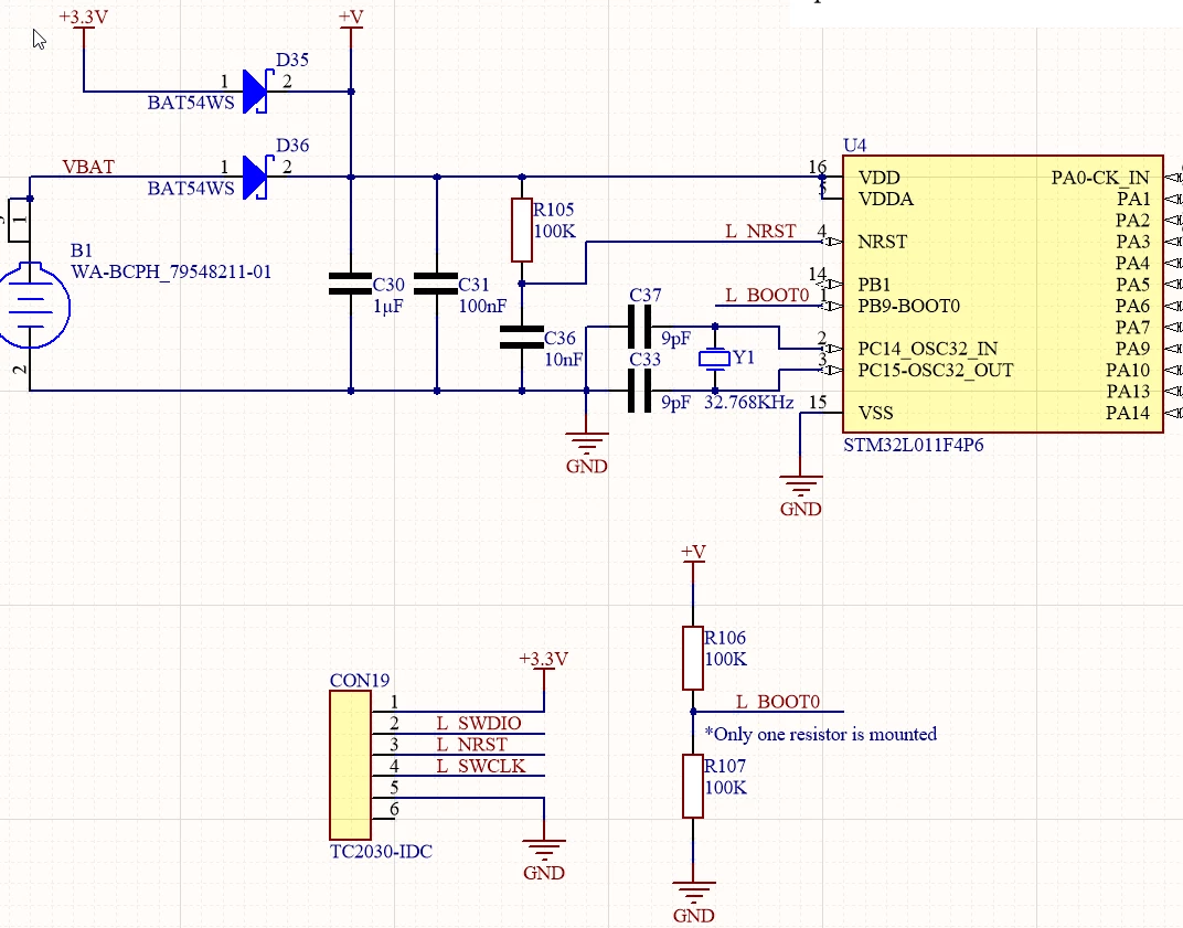

I have a low power controller which i will use as RTC.
type: STM32L031F6P7.
I use a custom board

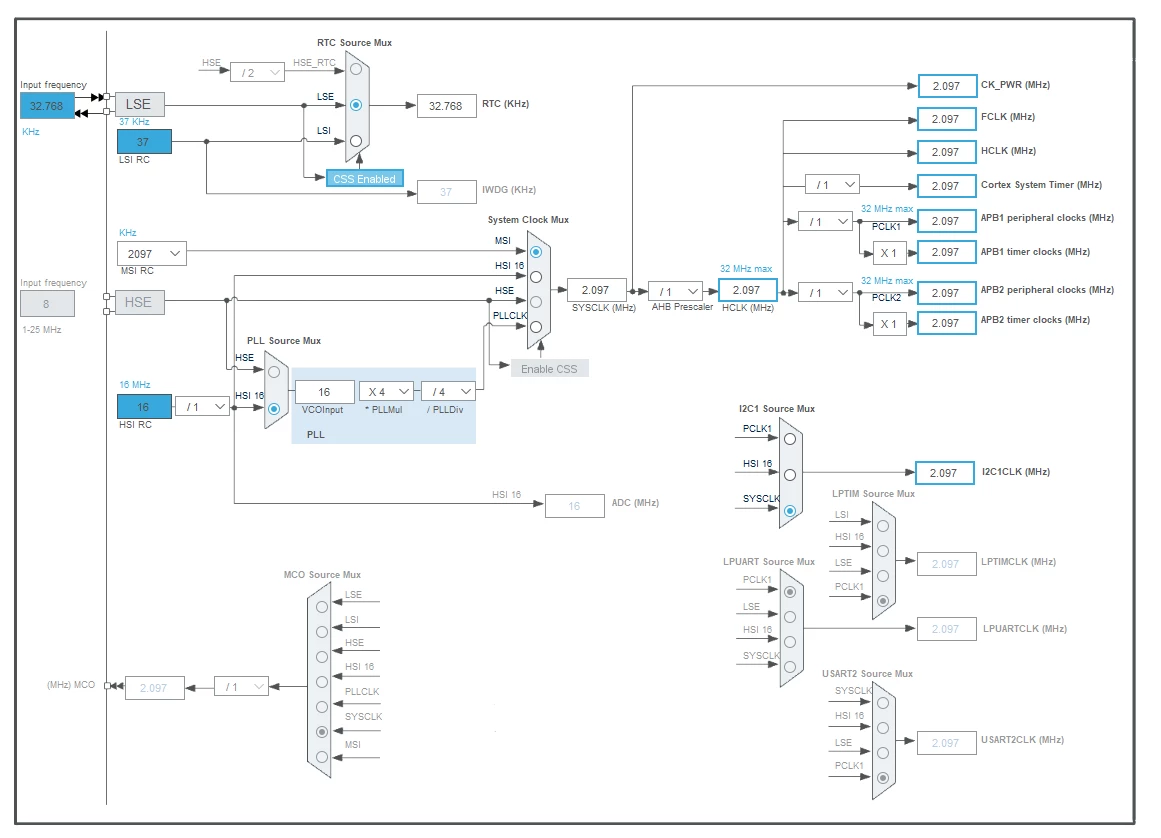

0693W00000GZDpfQAH.pngThese are the clock settings
I also notice there is no oscillating signal at PC15 . When should the LSE oscillator start? after powerup or after SystemClock_Config()?
The crystal is recommended by STM, and the PCB seems ok.

I haven't forgotten to answer to your original thread, I just don't know what to say. I don't have a 'L0 at hand, and I never encountered problems setting this particular bit on other STM32.
I would perhaps recommend to get rid of Cube/HAL and write a simple experimental code which does nothing just sets RCC_APB1ENR.PWRE and then tries to set PWR_CR.DBP.
Also, experiment with these things in debugger.
PS.
LSE does not start before you enable it in RCC_CSR, and you cannot enable it before you set DBP.
Also, you cannot measure directly on the LSE pins/crystal, as it's a ultralow-power circuit and your oscilloscope probe is too much of a load so it simply "chokes" it. Unless you are specially equipped for this (using ultralow-impedance active proble) LSE is to be measured indirectly, by outputting it to some pin through the STM32 - but in the low-pin-count package this may be a challenge.
Also, try experimenting on a "known-good" board such as Nucleo or Disco.
