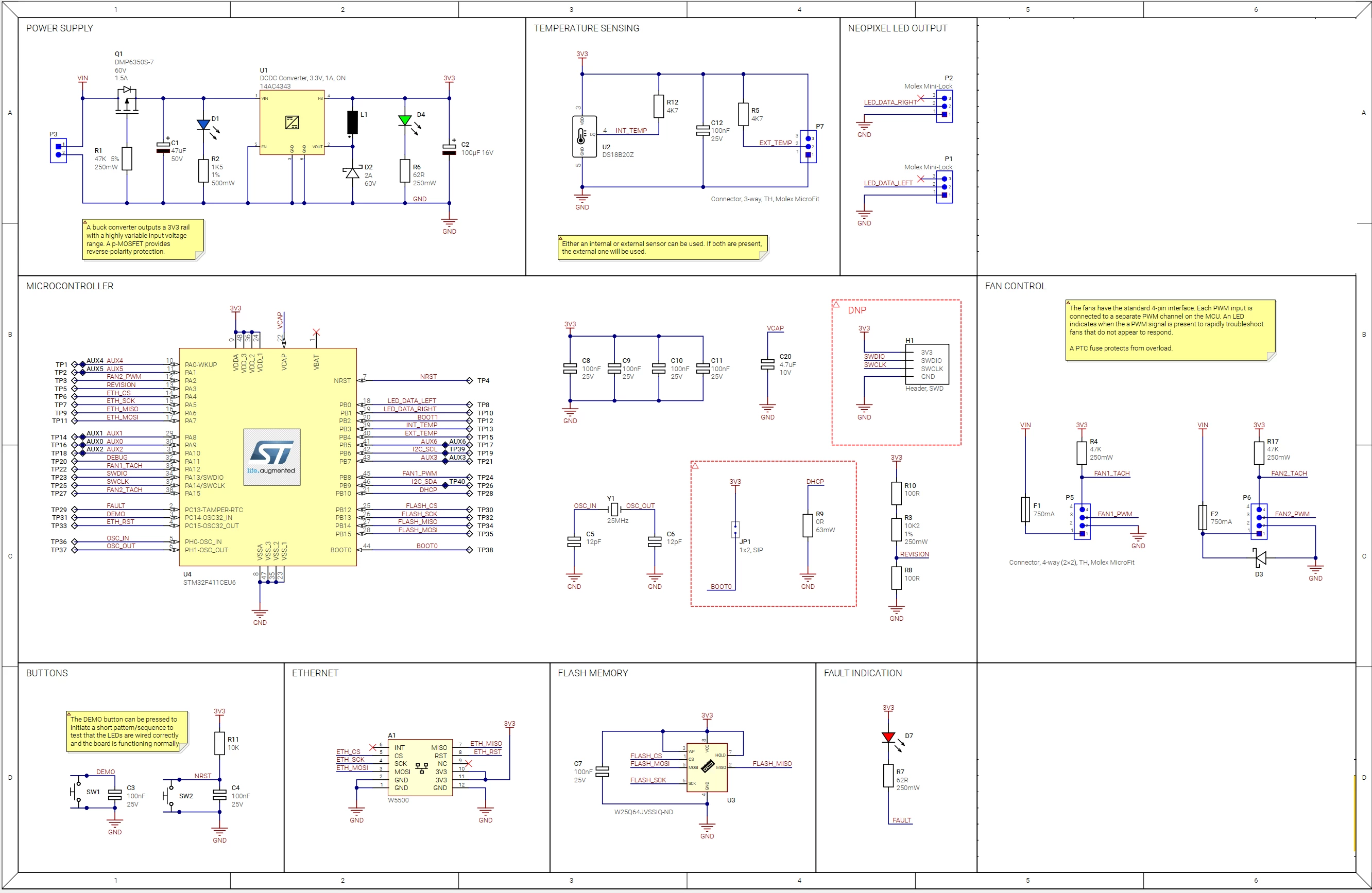

I have a board that is running well. There are about 50+ PCBs in production operating fine. The firmware is pretty complex, but the hardware relatively simple, just some SPI devices and some PWM outputs.
I revved the board, and the new board doesn't work at all. Well, it works enough to execute some code, but not much. So to debug, I started with a blinky program:
int main(void)
HAL_Init();
SystemClock_Config();
MX_GPIO_Init();
while (1)
HAL_GPIO_TogglePin(FAULT_GPIO_Port, FAULT_Pin);
HAL_Delay(1000);
}If I configure the RCC to use the HSI, the program gets as far as `HAL_Delay(1000)` at which point it chokes on `HAL_GetTick()`.
If I configure the RCC to use the HSE (a crystal is present), the program only gets as far as `SystemClock_Config()`, where it again chokes on `HAL_GetTick()` or sometimes `HAL_RCC_OscConfig()`.
By "choke" I mean it throws a HardFault. Though for a reason I can't understand, it won't execute my handler.
So, the code runs ok using the HSI at 16MHz until the RCC is configured. Then, whether configured to use the HSI/PLL or HSE/PLL, it continues to execute until the first HAL_Delay().
I don't think there is anything about `HAL_Delay` specifically, since all it does is return a `volatlile int`; but rather execution becomes unstable once RCC is configured.
So, what could be causing RCC to freak out?
Power supply is a smooth 3.300V and there are 4 100nF bypass caps, one per Vdd/Vss pair, and Vcap has a 4.7uF.
The only thing I see that I missed is that BOOT0 doesn't have a pull-down.
A redacted schematic is attached.
