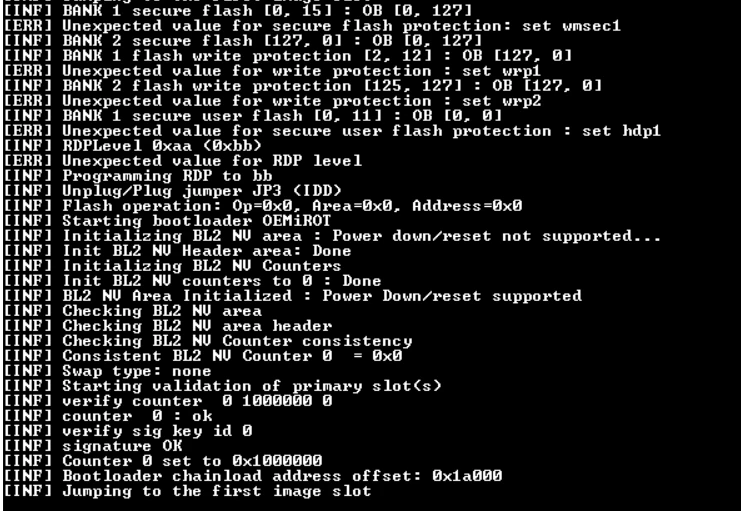

Hi I am working on SBSFU Application project from STM32U585 project. I have done below changes to the existing project.
1. Added my project code SBSFU_Appli_NonSecure project.
2. Previously this project was assigned 192KB and it was hardly using 3% of it. And now the requirement is of more RAM, I have increased RAM boundry to 256KB as below in STM32U585AIIX_FLASH.ld
RAM (xrw) : ORIGIN = NS_DATA_START, LENGTH = 256KB/*NS_DATA_SIZE*/
3. Now what I am seeing is I am not getting to jump to NS main() after this
"[INF] Jumping to the first image slot"
Same kind of experiment I have tried in TFM project and it worked, but I am not able to get the catch here.
Need help, thanks in advance...

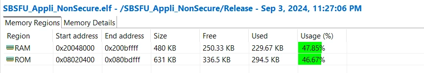

September 3, 2024
Hi Jocelyn, thanks for details support. I have followed as you have mentioned and now I am able to accommodate my application into SRAM3. Compilation is happening successfully. And I could see build analyzer.
But when I run my application I still see my code is not jumping into application.
While with SRAM1 usage my application works file(limited the RAM usage)
Any idea about this.
Thanks,
Nitin

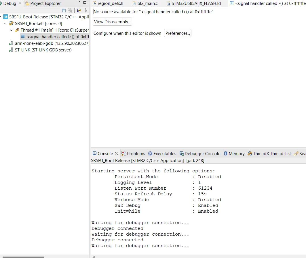

Jocelyn RICARD
September 4, 2024
Hello Nitin,
I provided the changes needed that should make your project work.
Please attach the debugger to the target without downloading anything, just symbols to understand where it fails
Best regards
Jocelyn

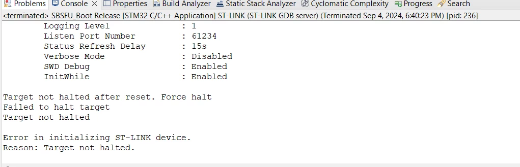

September 4, 2024
Hi Jocelyn, since past two months we are not able to debug TFM /SBSFU projects and we are getting errors. We have tried with multiple debuggers and devices.
or
We have followed below link initially, then we were able to debug, but now it's not happening.
https://youtu.be/rlmQhfXyYCQ?si=x84MhCet_-n1TJ3U

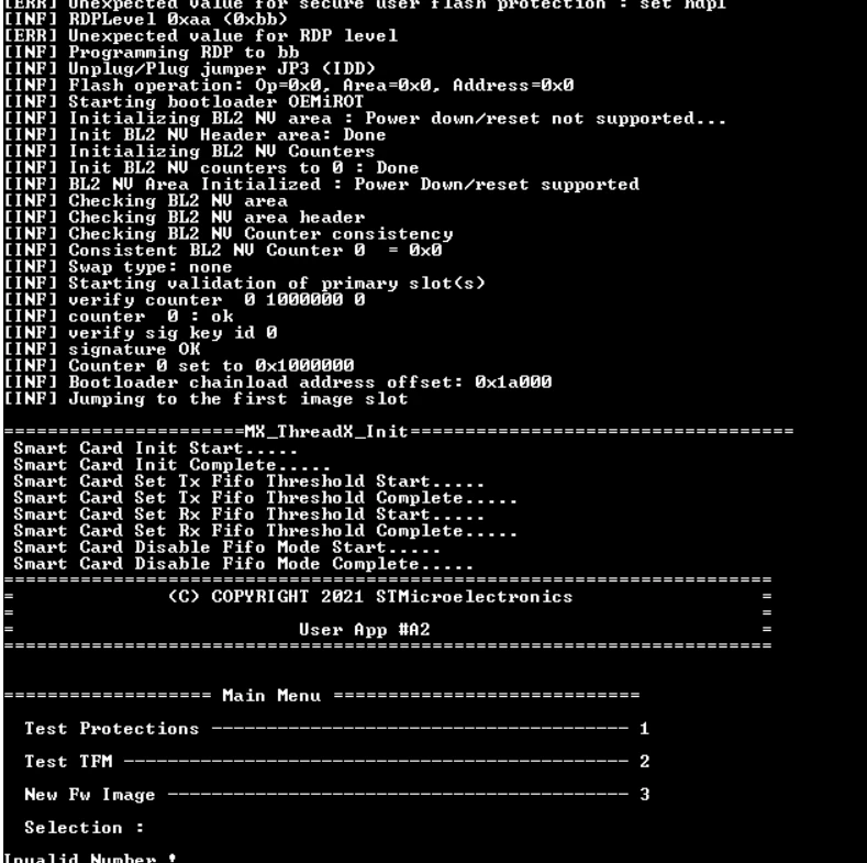

NitinAuthor
September 4, 2024
Hi Jocelyn, SRAM3 application run it is working out now. I did a small change in unsecure_sram3() definition as below

Other changes are necessary indeed. I'm sorry I forgot to mention them. If you can edit your post for test protection to add _2 at the end.
For debugging, you must disable the RDP at least. Please also disable HDP and WRP.
If you disabled protection debugger should be able to attach.
