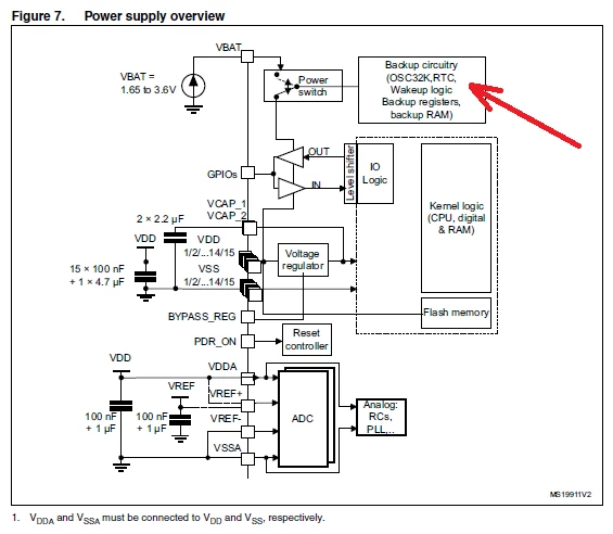

Hello ST lovers,
I have a very simple yet critical to my project question : is the RAM in the STM32F405 erased upon reset ? If yes, then is there any EEPROM I can use to store 32 bits of data that'll survive through reset ?

    The SRAM is not erased by a reset, although regions might be moved, or cleared by the C Run Time's start up code as it runs.
    The SRAM at power up has undefined content.
    Certain STM32 parts have registers or RAM areas backed up by the battery in the VBAT power domain.

    All I'm doing right now - I'm at the very start of this project - is thinking about how and where to boot. And my boot module might use a temporary boot address (to test a new firmware) that it could store in the SRAM. So if the SRAM survives a reset then I'm good, and after booting I don't need that variable anymore so my CRT will be free to do whatever it wants.
    And if power lacks, the SRAM is scrambled, but my booter has a main boot address in Flash (pointing to a firmware I know to be working), so I'm also good. But what you say is interesting : what do you mean, Vbat power domain backup ? How can it backup anything if there's no power anyway ?

    With no power you'll need to use FLASH. If you have a battery or supercap, use that to preserve across a cycle in the primary supply.
