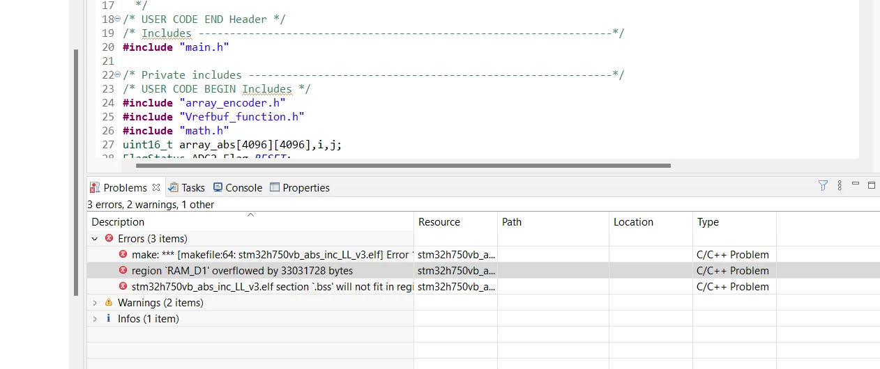

ram_d1 overflowe ?
I use stm32h750vbt6, I got the ram_d1 zone overflow error.What I don't understand is why the ram_d1 region zone overflow0693W00000HqWUAQA3.png doesn't write to other ram regions.

The D1 region only provides 512KB RAM in the STM32H750VBT6.
But you define an array_abs with 4096x4096x2 = 32MB - how should this fit into these 0.5MB?
