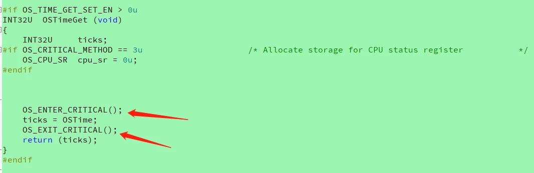

Hi,Master:
Question 1:
As shown in the figure below, why does the api read this variable with critical protection?
0693W00000GXyJiQAL.pngQuestion 2:

    1) It is unnecessary as reading int32_t is atomic. You would need to ask the author why it's there.

    Lacking additional context I'd assume this is coded to handle a 16-bit (or 8-bit) MCU​

    I've never seen OS_ENTER_CRITICAL() / OS_EXIT_CRITICAL().
    By searching on Internet I see these functions seem related to uCOS and not related to STM32 specifically.
