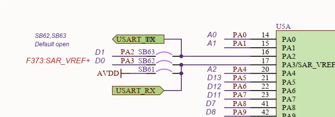

I'm starting to get familiar with the STM32 Series of Microprocessors and I'm completing some exercises using a mixture of direct writting to peripherals and low level ST libraries using the CUBEMX to get familiar with the chips. I'm using the Nucleo -F072RB
At this point I stumbled across a challenge, regarding the ADC module. I don't seem to be able to read the values on chanel 2 and 3 (PA2 and PA3).
Using the code below I can read PB0 (Channel 8) just fine. I ave also tried to read te internal temperatre sensor and reference and they seem to work fine. Any ideas why the inputs at PORTA don't work?

After sucess probing the the chip pins themselves, seems as the points on CN9/CN10 are left unconnected, on the nucleo board, by default (PA2/PA3 on CN9/CN10). A dig into the shematics shows a couple of test points, out of which SB62 and SB63 were left open.
0693W00000Lz1h2QAB.pngOnce the SB62 and SB63 points were closed, the ADC readings were as axpected.

Good news,
