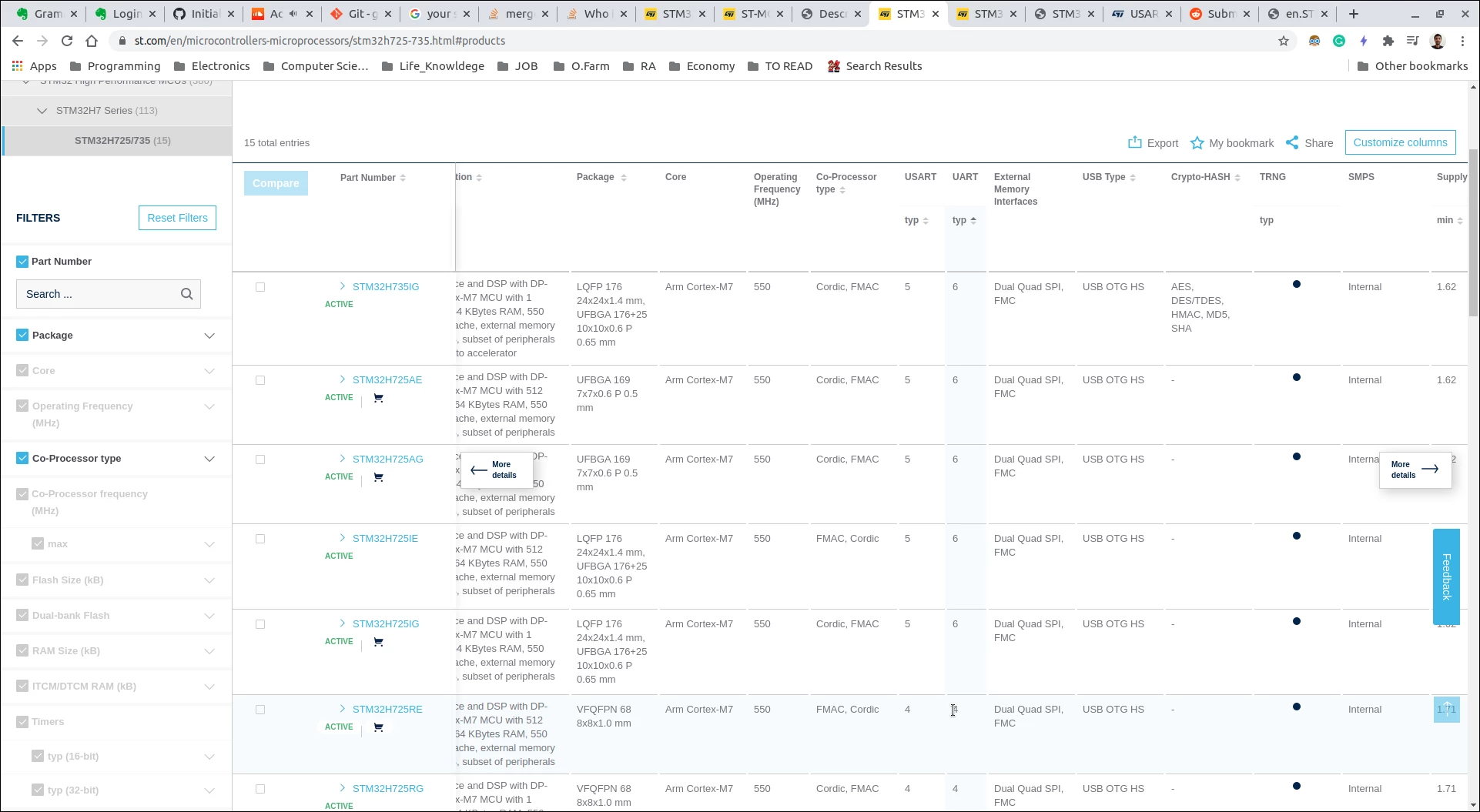

Question1: How to know the designated USARTx & UARTx for a particular STM32 line? Question 2: Is there any available document outlining the availability of USART or UARTx peripheral to a particular line?
I did check the reference manual, but it was not stated. I have also seen in an image the same core has different counts of UART. Hence I am a bit confused.

The pinouts and pin assignments are documented in the datasheet, along with electrical and timing data.
ST has always had this splitted documentation style, a datasheet, and a reference manual for a detailed description of the peripherals.
Other companies do it all-in-one.

Hi @Manojkumar Subramaniam​ ,
Product's datasheet is the reference for pins assignment as already highlighted by @Ozone​.
But there is also the tool STM32CubeMX which offers a rich easy-to-use graphical user interface allowing the configuration of:
  • Pinout with automatic conflict resolution
  • Peripherals and middleware functional modes with dynamic validation of parameter constraints for Arm® Cortex®-M core
  • Clock tree with dynamic validation of the configuration
  • Power sequence with estimated consumption results

I am about to compare the available number available of UART/USART of the same family. Look like currently, I'll have to open the datasheet of each interested MCU's datasheet to findout. No other tool to help out to compare among the family?
