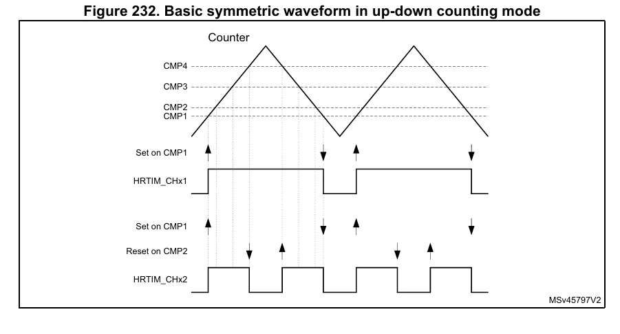

I have a question while reading the reference manual RM0440.
On page 915, Figure 232 shows a timing diagram where the event is labeled "Reset on CMP2". However, looking closely at the waveform, the HRTIM_CHx2 output seems to be reset at CMP4, rather than at CMP2 as the text implies.
Could anyone help clarify this? Is this a typo in the manual, or is there a specific HRTIM mechanism/priority that causes the reset to actually happen at CMP4 in this scenario?
Any explanations would be greatly appreciated. Thanks in advance!

Hello ​@latiao and welcome to the community.
Thank you for bringing this issue to our attention.
I reported this internally for checking.
Internal ticket number CDM0064935 (This is an internal tracking number and is not accessible or usable by customers).
