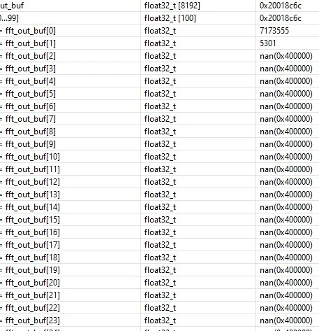

Hello!
I am trying to simulate an octave model on a microcontroller and ran into a snag I thought I'd get some help with.
So I have an FFT I am running on a sample of data (we'll say 4096 bytes). In octave, I'm using an FFT of the sample (where the sample is a 1 x 8192 array):
fft_data = fft(sample);
Pretty straight forward function. I have the data extracted to a csv file for comparison to ensure the data matches up.
I am now trying to replicate the fft on a microcontroller. I thought I had set it up correctly from a few forum posts but I can't tell if I'm using the wrong type of fft, the wrong data size, etc. Below is essentially what I have on the microcontroller:
float32_t sample_flt[4096] = {0};
float32_t fft_out_buf[4096] = {0};
arm_rfft_fast_instance_f32 fft_handler;
arm_rfft_fast_init_f32(&fft_handler, 4096);
arm_rfft_fast_f32(&fft_handler, (float32_t *)sample_flt,(float32_t *)fft_out_buf,0);
When I'm looking at the contents of the sample, I'm getting sample[0] and sample[1] filled with information (that doesn't match my octave data) and the rest are nan.
Is it safe to assume the nan is because it's a complex number and can't be displayed?
Am I using the fft correctly or am I setting something up wrong?
I think I am close but I think I'm missing something really simple.
Any information you can give me would be greatly appreciated. Thanks!
NOTE: Edited original code posted to reflect fft init command that I forgot to add to post (but is in code).
Additional info given in post below as well.
Best answer by KnarfB
My link from above lists limitations, so 8192 seems to be out of bounds.

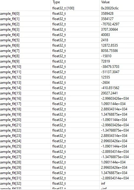

September 8, 2021
Some additional context about what is weird, I expected to get the real portions stored in sample_flt and the imaginary portions stored in fft_out_buf, which I believe how this code works (or at least how it appeared to work in other code).
What was odd about this is that I received 16 "normal sized" real samples in sample_flt (without exponents), 16 additional real samples (with exponents in the xxxxe+034 range), and then the rest seemed to vary between the inf, -inf, and nan.
For the imaginary portion, I received two "normal sized" imaginary samples and the rest were all nan.
I expected I might have some differences between octave and this that I might need to resolve/understand, but it seems odd to have such massive differences, which makes me think I am doing something wrong. What's odd is this doesn't seem to be a particularly complicated function so I'm not entirely sure what the core of the issue is.
For reference, here's what Octave provided:0693W00000DmTd0QAF.jpg
Here's the real portion (sample_flt):
Here's the imaginary portion (fft_out_buf):
KnarfB
September 8, 2021
No, nan stands not for a complex number. There is no complex hardware data type on STM32. Complex numbers are stored as two consecutive real number (re+im part). Are the arrays global (static) variables? Otherwise it could be a stack overflow.
Try a smaller example first. Like so:

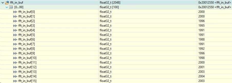

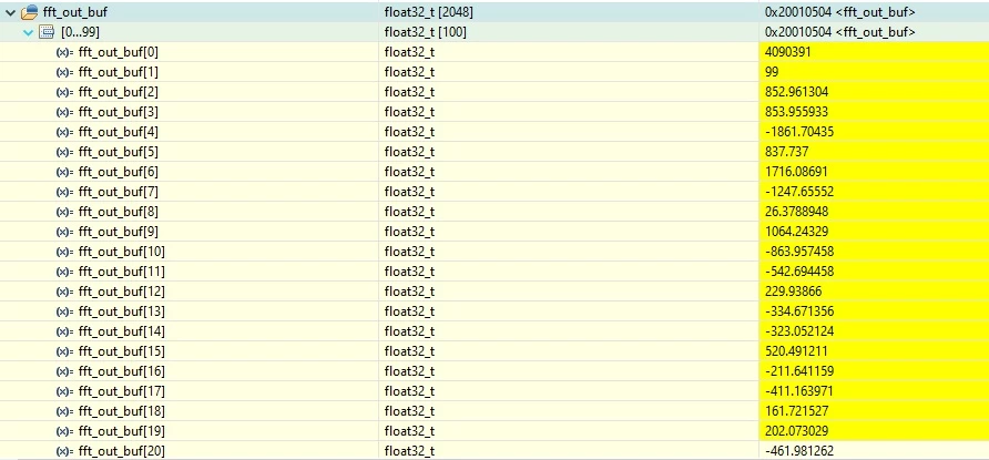

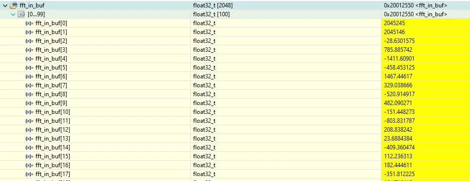

September 8, 2021
Thanks for the help with this!
I actually was working with an example from this site:
http://stm32f4-discovery.net/2014/10/stm32f4-fft-example/
I ported it over to a different microcontroller and made a few changes (mainly hardware related, bin size, sample rates, etc) and the FFT portion of the code looks like this:
float32_t fft_in_buf[2048];
float32_t fft_out_buf[2048];
arm_rfft_fast_init_f32(&fft_handler, 2048);
 //Do FFT
	arm_rfft_fast_f32(&fft_handler, &fft_in_buf,&fft_out_buf,0);
	int freqs[1024];
	int freqpoint = 0;
	int offset = 0; //variable noisefloor offset
	//calculate abs values and linear-to-dB
	for (int i=0; i<2048; i=i+2)
		freqs[freqpoint] = (int)(20*log10f(complexABS(fft_out_buf[i], fft_out_buf[i+1])))-offset;
		if (freqs[freqpoint]<0) freqs[freqpoint]=0;
		freqpoint++;
float complexABS(float real, float compl) {
	return sqrtf(real*real+compl*compl);
I then put in a 2.2khz tone into the mic (which I can only assume is the same frequency modems used back in the day by my ears) and ran through the code. It appears to be working as expected, even with my changes (it had an external GUI for doing a spectrum analysis and it analyzed the core frequency spike correctly, which is good).
This is the data before running the FFT:0693W00000DmZMZQA3.jpg
Here is the data post FFT:0693W00000DmZJlQAN.jpg0693W00000DmZQ2QAN.jpgSo my understanding (based on the above example) is the out of the FFT function (fft_out_buf) was the imaginary portion without the i argument, would I be wrong about this? If that is the case, I'm a bit confused as to why I'm getting the results I'm getting. If my understanding is wrong though, that could be an explanation. I tried converting the values in my project using that same complexABS function but the output of my project just gave a bunch more nans.
