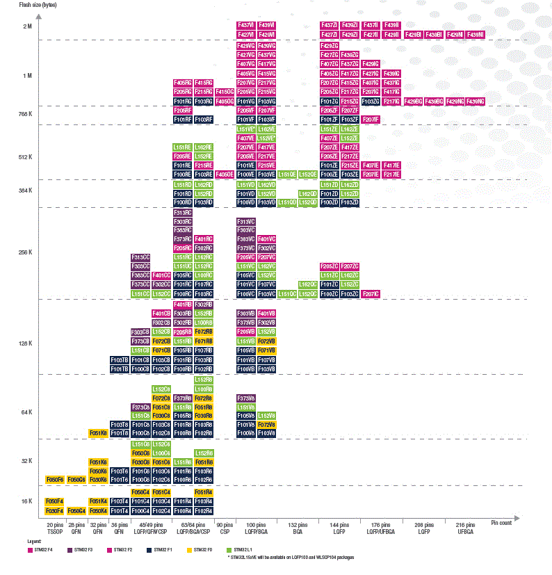

In the context of your question,
Define STM32
Define Very High Speed
The FIFO is there to mitigate memory contention issues wrt source and target devices.

The model is STM32F205.
With very high speed I mean a peripheral sending bytes very fast. E.g. UART @921600 ( a byte every 10us )
