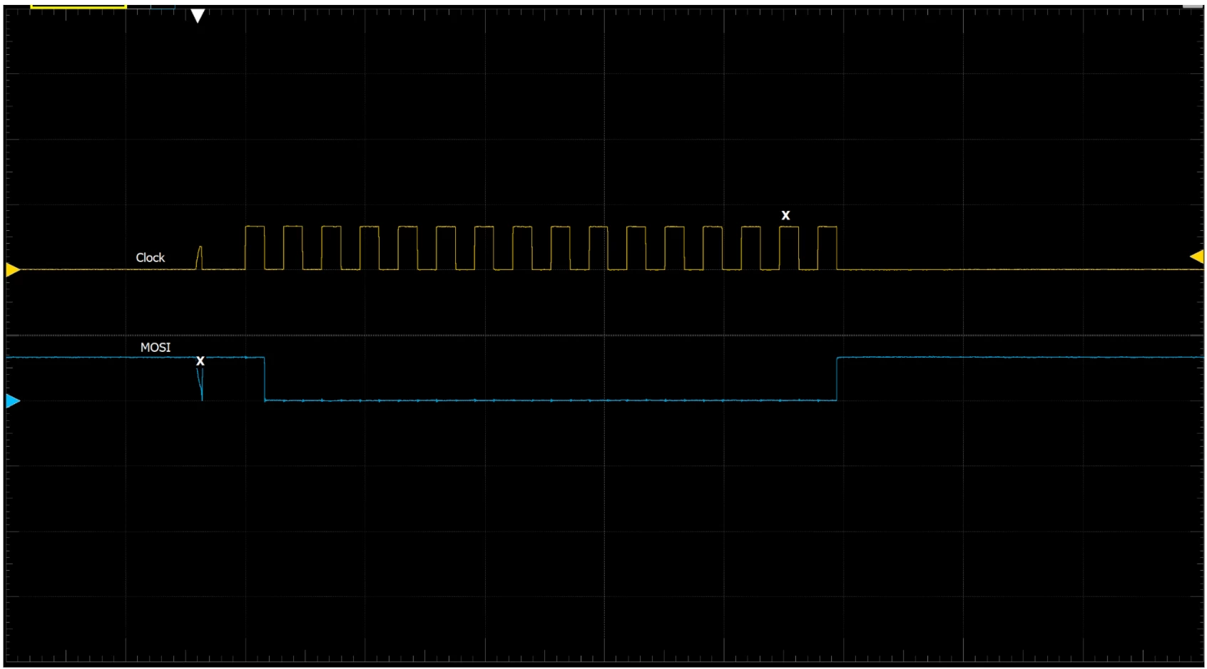

Hi
I am learning to write driver code for SPI. I have an nucleo-L476RG development board with me implementing full-duplex transmit only operation and reading the output of a MOSI pin using a logic-analyzer. The Nucleo board is working as the master
So far this is my understanding of the SPI based on the reference manual.
  1. 2 x 32-bit FIFO buffers one for Rx and One for Tx
  2. The number of data that can be transmitted : 4 bits - 16 bits, it can be configured in the CR2-> DS register of the respective peripheral
  3. When the data < 8 bits the data is packed to 8 bits, when the  8< data < 16 bits the data is  packed to 16 bits
SPI Parameters
SPI Peripheral - SPI1
Clock Frequency - 4 MHz
Baud Rate - SYS_CLK_DIV_64
CPHA - First Clock Edge
CPOL - Zero when Idle
LSB First - Data transmitted with MSB first
Data Size - 8 bits per frame
Communication Mode - Full duplex(BIDIMODE:0, BIDIOE:0, RXONLY: 0)
Software Slave Management - Enabled
Internal Slave Select -1

Output from logic analyzer:
Case: 1 Data transferred: 0x1

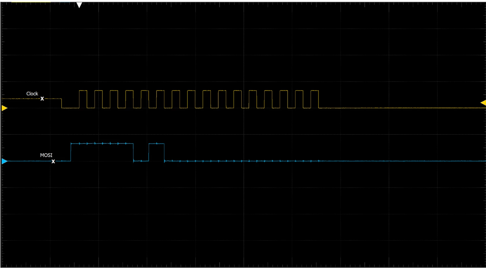

0693W00000JPooRQAT.pngCase :2 Data Transferred : 0x2F, Data Size(DS= 4)
0693W00000JPoobQAD.pngI have implemented the blocking call for SPI so far in my logic,
Questions:
  1. In Case-1 I have set the DS size to 8 bits and my data is also of uint8_t why then is 16 clocks sent from the master?
  2. In Case-2 when the DS is set to 4 bits why are the bits after 4 bits sent(binary of 0x2F is 0010 1111)?

TDKBest answer
February 15, 2022
1+2) Show the actual code. You may be sending more data than you think due to data packing.
3) You can see max frequency of pins vs speed setting in the datasheet. If it's working, it's probably fine.
4) Writing 3x 8-bit values to DR in 2-line mode will produce 24 clocks.

Tbone1
Tbone1Author
February 16, 2022
Hi TDK,
Thank you for your inputs, based on it I found that the controller was writing 16bit to the SPI1->DR register. Earlier I had implemented it as
//8 bit transfer ,pTxBuffer = pointer to uint8_t
pSPIx->SPI_DR = *pTxBuffer;
Now It works when after typecast now the code looks like
*((uint8_t*)&pSPIx->SPI_DR) = *pTxBuffer;
Now the logic analyzer send out 8 bit when the data size is configured as 8 bits
@Community member​  If you are still figuring out why 16 clocks are sent out when the data size is set as 8 bit, this might be a possible solution

My quick checklist:
The number of sck clocks depends on data transmitted, even dummy one when need to read from slave.
A master sck clock is completed once the reception is complete, not transmit buffer empty which is to avoid pause between transmitted bytes. The fifo relaxes this further.
The fifo is sensitive to the core data bus, if you write 8 bit, 8 bit is queued, if you write 16 bit, 2x8 bit will be queued for the 8 bit spi.
