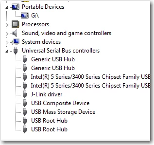

    Posted on September 11, 2013 at 17:37
    so just make it CD = 0 in the code then...?
    I just make :
    GPIO_ResetBits(SD_DETECT_GPIO_PORT, SD_DETECT_PIN);    // set pin low
    windows can detect it but can't read the SD yet....any ideas why ?
    thanks
