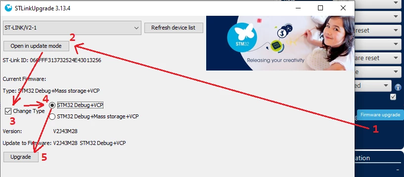

i'v tested the nucleo on arm mbed, very nice.
but, when i use the onboard stlink v2.1 to debug my application board, the mbed mass-storeage disk is always pop-up a window.
so, can i disable this disk (not by disbable the system autorun function), only keep the stlink swd & cdc functions?

    As said by @Andrew Neil , you can disable it by changing type but you can do it with CubeProgrammer:
    Click "Firmware upgrade button" Then click "Open in update mode" button. Check the box "Change type" , finally select "STM32 Debug+VCP" and click "Update":

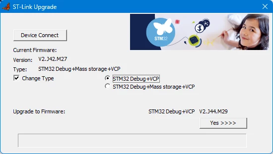

    I also had this question, and a forum search found this unanswered post.
    I load code direct from the IDE - I don't use the mass storage - so the pop-up of the file explorer window is just a nuisance.
    Turns out there is a way to disable the mass storage feature of the ST-Links on Nucleo boards:
    https://community.st.com/t5/stm32-mcus-boards-and-hardware/st-link-on-nucleo-boards-without-connecting-an-usb-memory-device/m-p/191920
    it uses the ST-Link Updater, STSW-LINK007: https://www.st.com/en/development-tools/stsw-link007.html
    That gives you the option to change the 'Type' from 'Debug + Mass Storage + VCP' to just 'Debug + VCP'
