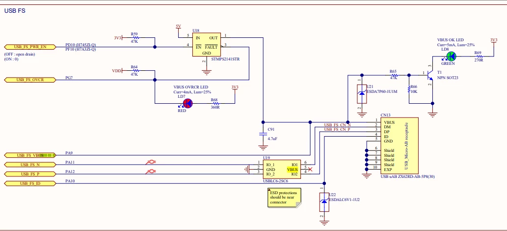

>When STM32 is configured as Host mode, should the STM32 source 5 V onto VBUS?
when STM32 is configured as host you need to configure a specific pin as output (based on your product) to power the device part through the Vbus sensing pin
for example PG7 if you are using Nucleo-H755 :

There is no way any STM32 can *source* 5V.
VBUS is input to a comparator, its output can be read as a bit in some of the OTG registers, and if set as interrupt source, it can trigger that interrupt. That's all. Now how you treat this signal/bit/interrupt in your code - and "your code" includes any library you are using - is up to you.
Note, that voltage on even 5V tolerant pin must not exceed 4V against VDD, even when the mcu is powered down.
You may want to check schematics of some of the STM32 demo boards such as Disco, for inspiration.
