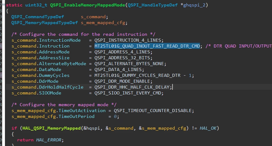

question about stm32h750bdk ExtMem_boot
Inside the QSPI_EnableMemoryMappedMode function, the dummy cycles are MT25TL01G_DUMMY_CYCLES_READ_QUAD_DTR - 1.

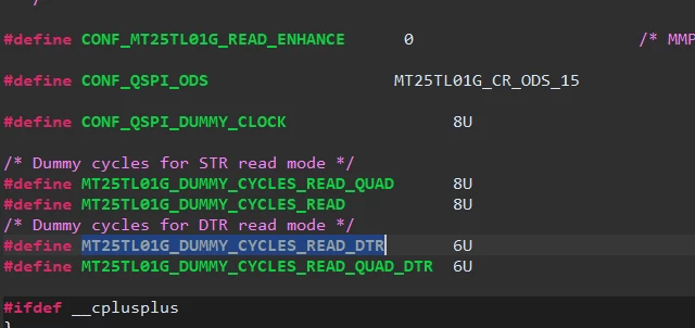

MT25TL01G_DUMMY_CYCLES_READ_QUAD_DTR is defined as 6U.

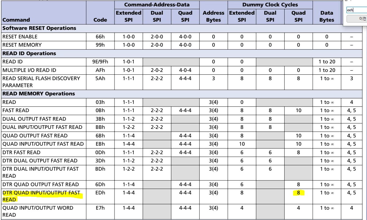

The datasheet for MT25TL01G states that the DTR QUAD INPUT/OUTPUT FAST READ value is 8.
Why is MT25TL01G_DUMMY_CYCLES_READ_QUAD_DTR defined as 6?

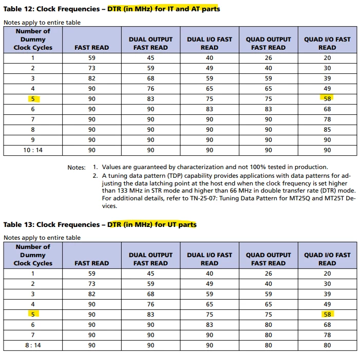

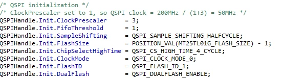

The dummy cycles "s_command.DummyCycles = MT25TL01G_DUMMY_CYCLES_READ_QUAD_DTR - 1;" depend on the QSPI clock frequency and on parts specification as mentioned in the memory datasheet.
In the ExtMem_boot case QSPI clock is 50 MHz, that why dummy cycles are 5.
For MT25TL01G_DUMMY_CYCLES_READ_QUAD_DTR as 6U definition is contradictory with the memory datasheet, I reported internally.
