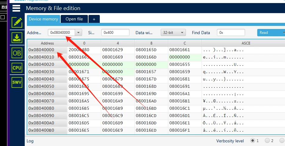

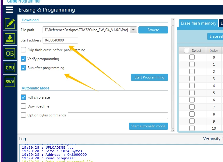

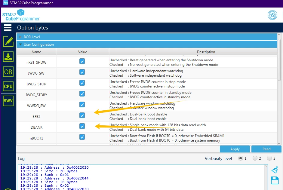

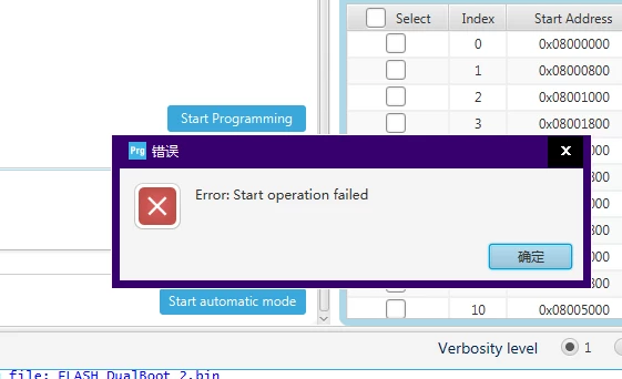

April 25, 2025
the process below:
微信图片_20250425193045.png微信图片_20250425193143.png微信图片_20250425193211.png微信图片_20250425193232.png微信图片_20250425193255.png微信图片_20250425193314.png微信图片_20250425193350.png

May 3, 2025
Both banks will be swapped with BFB2=1 and all addresses from BANK2 will be remapped to BANK1 (and vice versa).
Otherwise the flash addresses, generated by compiler, would all be wrong. So the start address for booting from BANK1 (BFB2=0) and from BANK2 (BFB2=1) also stays the same virtually @0x08000000.
If you want to ask if you booting from BANK1 or BANK2 you can read the memory remap status in MEMRMP register:
DWORD GetBootBank(void)
 return (READ_BIT(SYSCFG->MEMRMP, SYSCFG_MEMRMP_FB_MODE) == 0) ? FLASH_BANK_1 : FLASH_BANK_2;
