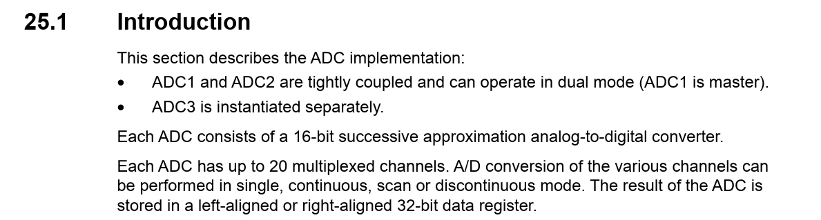

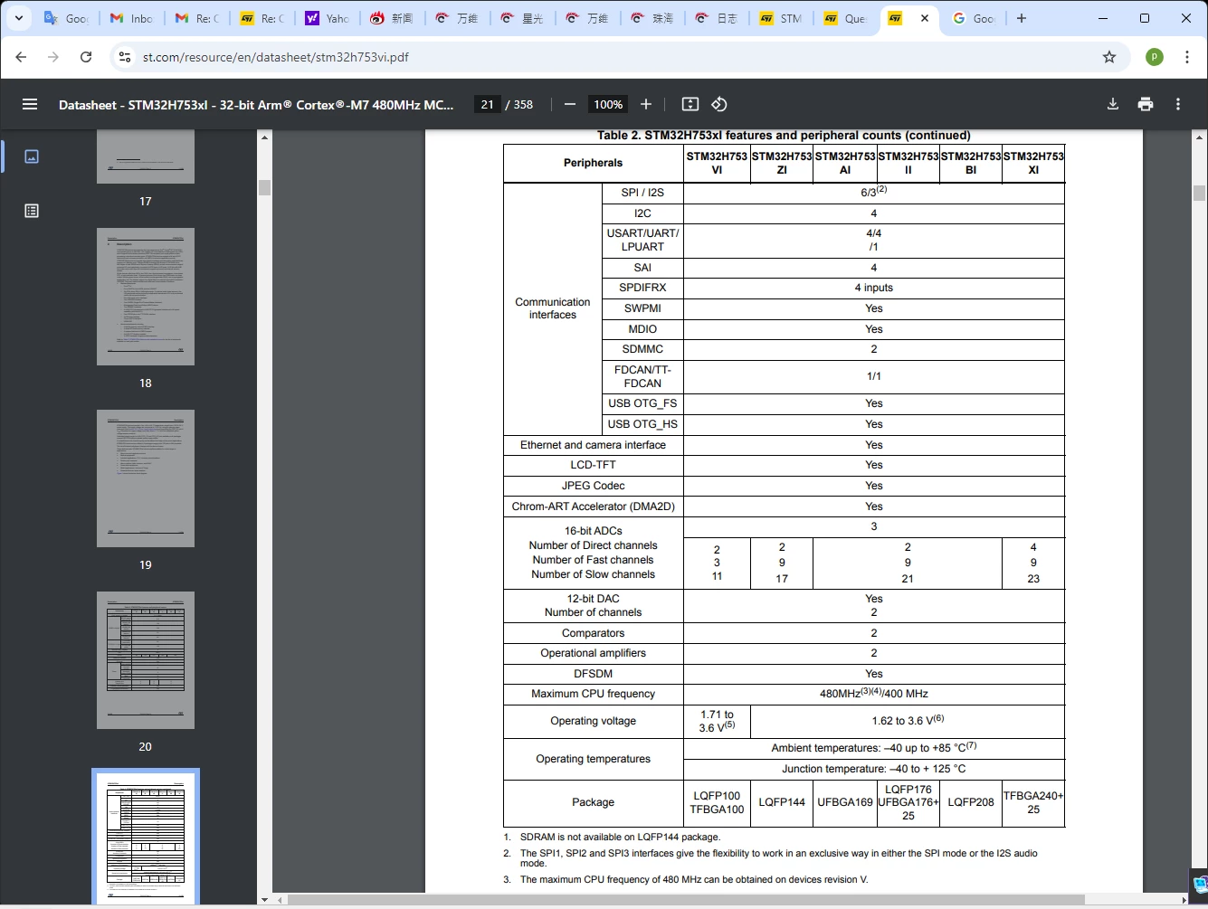

Nov 17, 2024 9:19 PM UTC
1. look in ds. + see cpu selection tool.
Below shows  having 3 of16-bit ADCs - Are they independent?
Below shows STM32H753ZI has 2 direct channels, 9 fast channels, 17 slow channels.
                                              Are they independent? Or only  2 direct channels independent?
Thanks
Rong
AScha.3
Nov 18, 2024 6:45 AM UTC
yes.
yes, independent .
see AN5354 :
You should read yourself, see rm :
So 1+2 can work in dual mode...but also separate.
