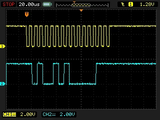

This is a question about Receive Only Master (SPI_DIRECTION_2LINES_RXONLY).
I was able to output the waveform shown in the attachment using Receive Only Master.
However, no data is being received(tmp). Why is this?
The process is performed in the following order:
HAL_SPI_Receive_IT(&hspi2, tmp, data_size);
HAL_SPI_Transmit(&hspi4, g_rx_temp_register, data_size, 1000);
hspi2(Receive Only Master)
hspi4(Transmit Only Slave)
About the waveform in the attached image
1ch hspi2 clock
2ch hspi2 MISO

Why are you doing two transfers?
which one is shown by your scope trace?
Why is the first one non-blocking (interrupt-driven), but the second is blocking?
The HAL_SPI_Receive()  will not have completed when you call HAL_SPI_Transmit() - so the HAL_SPI_Transmit() will be returning an error.
You should always check the return results!

Note that HAL does not use the receive-only Master - internally, HAL_SPI_Receive() calls HAL_SPI_TransmitReceive()
November 1, 2024
I forgot to point that out. Sorry.
The reason for the two transfers is that the customer has requested that the pins used for spi2 and spi4 be separated.
spi2 is the master receiving pin, and spi4 is the slave transmitting pin. Also, the spi2 clk line and the spi4 clk line are connected.
I'm sorry, I'm a beginner. What is a scope trace?
The reason for the distinction between non-blocking and blocking is that we want to perform the spi4 transfer process while the spi2 master's receiving clk is being output.
This is an abstract explanation, but spi4 must transfer using the clk output by the spi2 master. This is a customer request.
I think my settings are probably wrong. I understand that.
What kind of settings are necessary to achieve the above?
