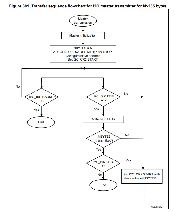

My code(sorry for code quality but  at the moment is only a test), I followed the datasheet flowchart(image in attach).
Do you think that I make some mistakes?

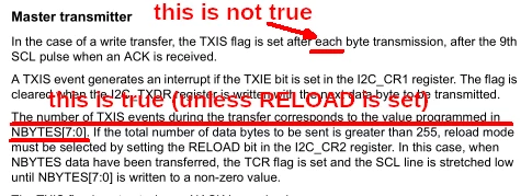

OK I think I understand what is the source of your confusion. I believe the flowchart is not quite correct. We might've discussed this here before, I can't find that thread at the moment.
> 1) Sometimes at the end of the transmission, the TC bit remain low but I notices that if I put some delay before the TC check it work(as if I had to wait a certain time first, but in the flowchat I don't see this)
After storing the last byte to TXDR, it takes time until it gets transmitted. Only after the last byte gets transmitted is TC set.
> 2) It's correct that for the last byte TXIS remain low?
Yes. Again, the narrative and the flowchart is not quite correct. The intention is, that TXIS is not indicator of "transmit register got empty" but "transmit register needs data"; the distinction is exactly that after the NBYTE bytes have been transmitted, there is no more "transmit register needs data" request.

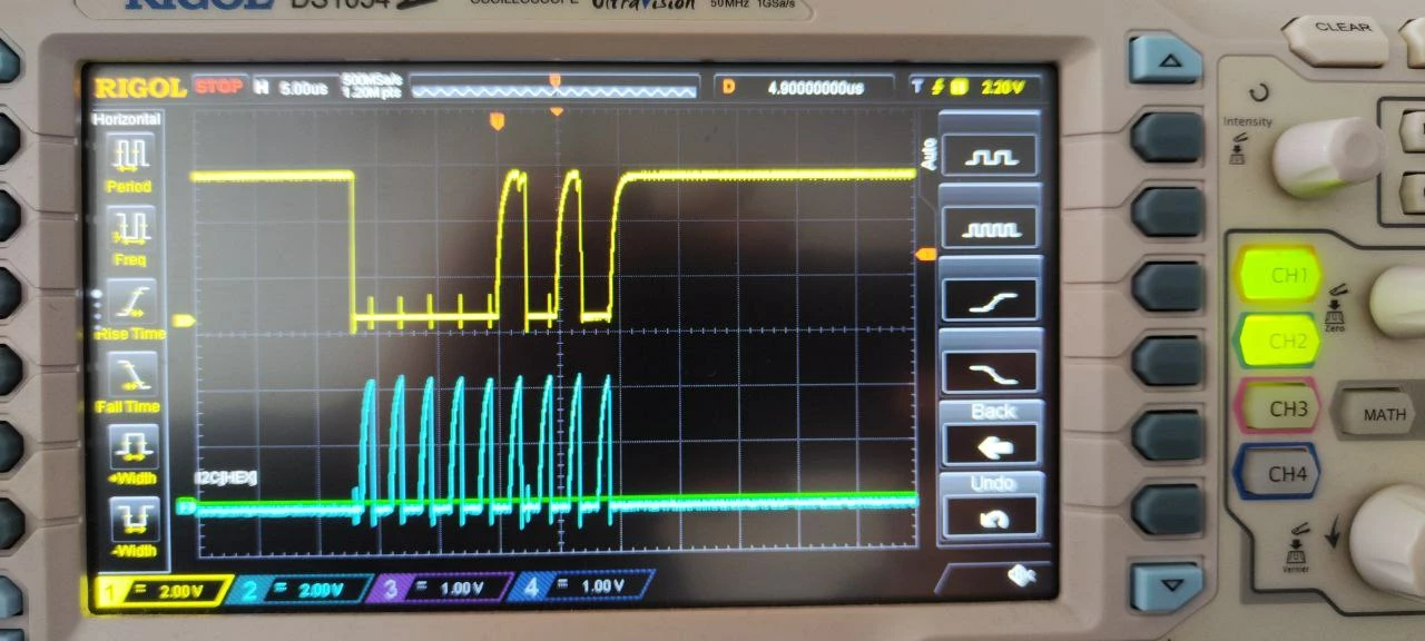

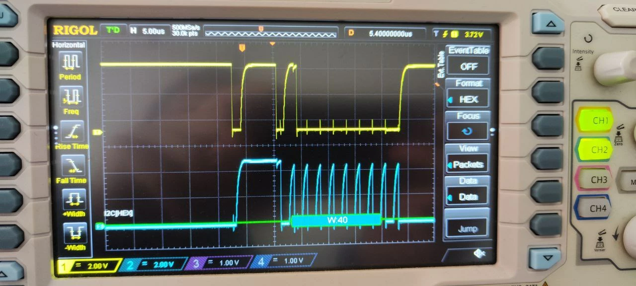

However yesterday night I have checked the i2c write using an oscilloscope, I sended:
start + 0x40 + 0x05 + 0x02 + 0x01 + stop
As you can see in attacched image it seems to work correctly(could you check please?)
