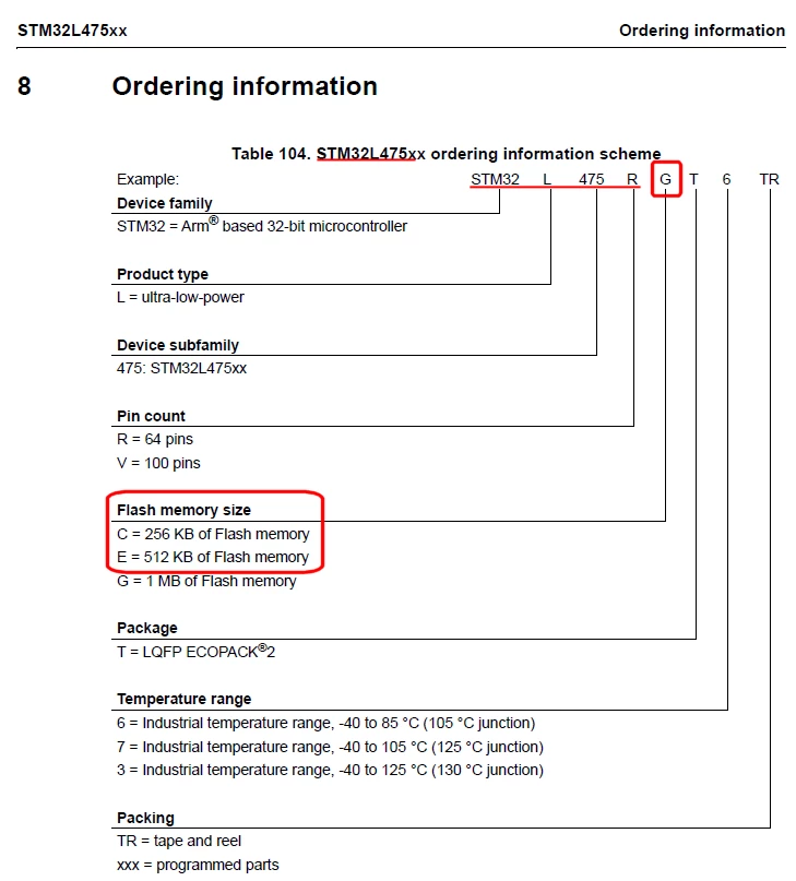

I have a project which is based on the STM32L475RC and now I want to upgrade to the STM32L475RE controller. I have changed the device from STM32L475RC to STM32L475RE in options for the target of the Keil environment. But the new project based on the STM32L475RE is not working. Any other steps to change the project configuration?

    Probably there's no difference between these two two chips, except for the FLASH size.

    @Community member​ STM32L475RC and STM32L475RE
    So the only difference there is the 'C' or 'E' suffix.
    As @Community member​ said, that's just the Flash size - as the datasheet tells you:
    "the new project based on the STM32L475RE is not working"
    So what, exactly, is "wrong" with it?

    I enabled the FPU module just after the main() in the RC project. It is working in RC but not working in RE. When I have disabled the FPU in RE then it is working fine. These are a few inputs along with the above. If I find any others I will share them with you.
