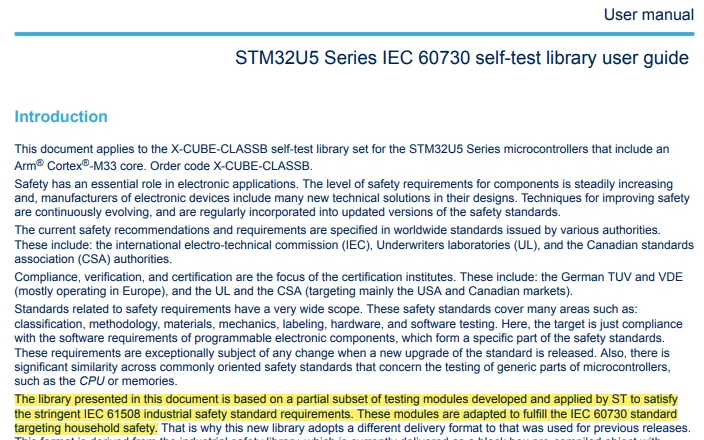

Hello team,
Greetings!
We have selected Trust zone MCU STM32U585ZIT6Q (U5 series) for our product (EV charger).
we have a query regarding the UL certification.

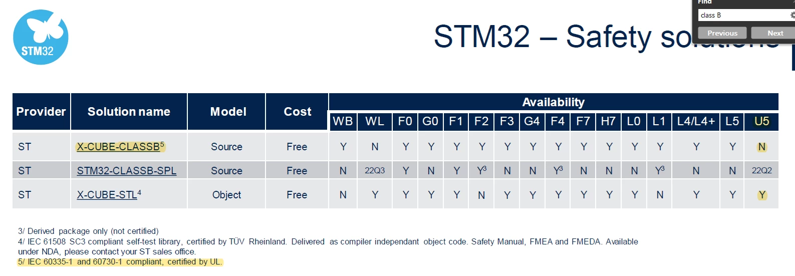

Based on the attached user guide snapshot, we could understand this U5 series chip have a Class B library that supports IEC 61518 and was adopted to fulfil the IEC60730 requirement.
But we understand that STM32U5 series is not in the list of MCU series (Pre certified) in UL certification for class B.
Is that ok to proceed with using this MCU in our product development and getting UL certification (UL1998/IEC60730) by integrating the Class B STL library available for U5 series, which is originally intended to satisfy IEC 61518?

we have found the UL/IEC60703 certification for the STM32U5 series below the link
https://www.st.com/resource/en/certification_document/e480533-20220630-certificateofcompliance.pdf

Loic CHOSSAT
May 29, 2023
X-CUBE-CLASSB for STM32U5 series is indeed available on st.com.
This is the X-CUBE-CLASSB-U5, rev4.0.0, delivered as compiler independant certified object code, with the associated UL certificate.
The package contains project examples with trustzone enabled or trustzone disabled. Please download the package and refer to the readme file and user guide.
