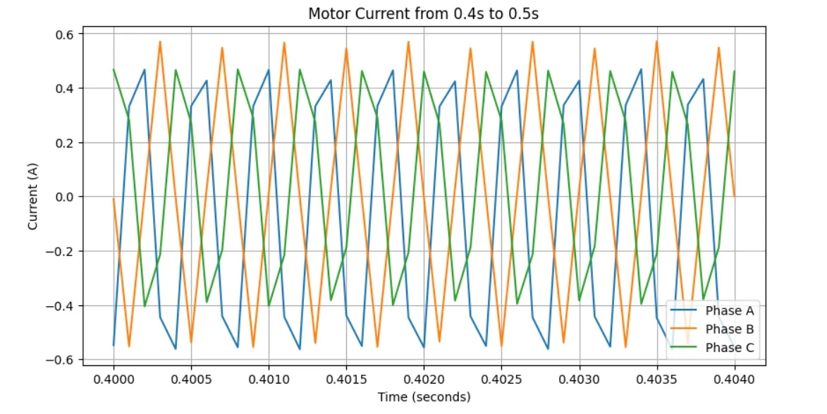

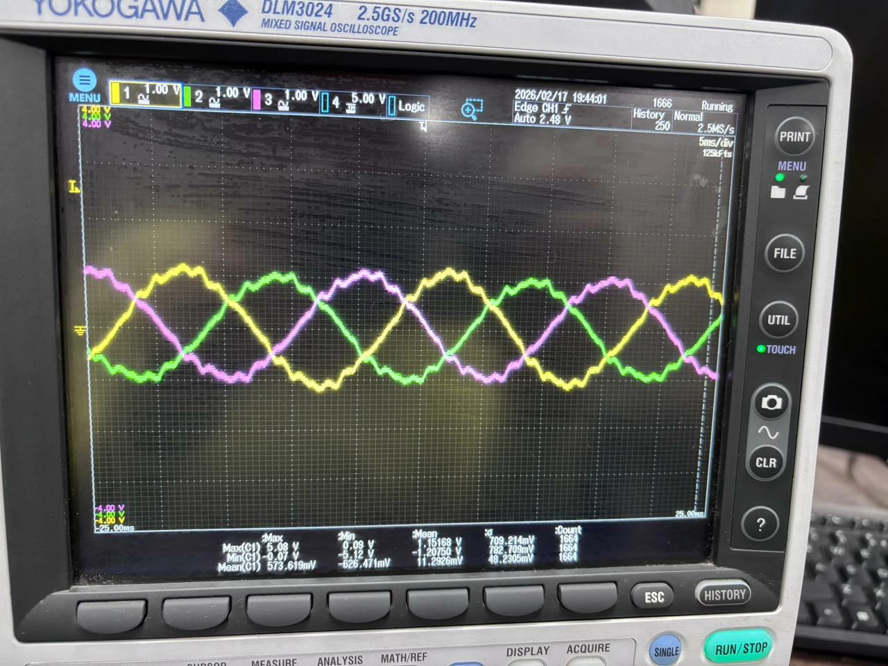

I am using ADC + DMA + USART1 + Timer in STM32 IDE in a setup consisting of:
Motor → Sensors → MCU (STM32N6) → PC
I am capturing the signal received at the serial port using NanoEdge AI. I have shared screenshots of:
  • The actual current waveform observed on the oscilloscope
  • The data received through the STM32N6 MCU
My doubt is:
Is there anything inside the MCU or ADC that could suppress or distort the natural sinusoidal shape of the current waveform?
Note:
  • I have converted ADC values to actual current values using a 3.3V reference.
  • I have removed the sensor bias.
  • I have properly accounted for sensor gain.
I would like to confirm whether the MCU/ADC processing could be affecting the waveform shape

Please use your scope's trace capture facility - it will give much better results than photographing the screen!
You need to set an appropriate sample rate!
Your graph shows that you are only sampling about once in each half-cycle ...

February 23, 2026
Thank you! I got the solution :)
LCE
Principal III
February 23, 2026
@chanchal94 we're always happy if the solution is shared for the next person running across the same problem.
P.S.: ADC data over UART: people often forget / oversee that the UART's baud rate is not high enough for ADC data.
February 23, 2026
My baud rate was okay, it was the timer issue, I checked it again as @Andrew Neil pointed out about sampling rate, I found out baud rate+ timer settings should be correct for this. My timer setting was a bit distorted.
