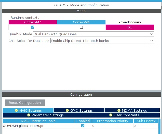

QUADSPI FLASH on STM32H747I-DISCO
I just would like to write/read to/from external flash on the development board and will really appreciate a hint how to make the easiest way.
I have configured QUADSPI interface only for M7:
QUADSPI Mode: Dual bank with qaurd lines
Chip Select for Dual Bank: Enable Chip Select 1 for both banks.
And use example application for STM32H7h7-EVAL board.
Right now the flash erasing command fails:
	 sCommand.Instruction = SECTOR_ERASE_CMD;
	 sCommand.AddressMode = QSPI_ADDRESS_1_LINE;
	 sCommand.Address = address;
	 sCommand.DataMode = QSPI_DATA_NONE;
	 sCommand.DummyCycles = 0;
	 if (HAL_QSPI_Command_IT(&QSPIHandle, &sCommand) != HAL_OK)
	 Error_Handler();
I'll appreciate any hints about this topic. May be there is a QSPI example for the STM32H747I-DISCO? Couldn't find it in the downloaded repo.

Fails how?
Try using the BSP code, and without interrupts.
Make sure the chip isn't in 4-bit address mode.
Make sure the sCommand structure is clean.
MT25TL01G_BlockErase(&hqspi, QSPI_Ctx[Instance].InterfaceMode, BlockAddress, BlockSize)
STM32Cube_FW_H7_V1.7.0\Drivers\BSP\STM32H747I-DISCO\stm32h747i_discovery_qspi.c
STM32Cube_FW_H7_V1.7.0\Drivers\BSP\Components\mt25tl01g\mt25tl01g.c

Apr 28, 2020 2:03 PM UTC
Oh. Thank you for the swift reply.
Falls like this:
There is a check for status In the HAL_QSPI_Command_IT
if(hqspi->State == HAL_QSPI_STATE_READY)
The dubugger shows that the vlue is "BUSY_AUTPOLLING". Without interrupts means just removing.
 HAL_NVIC_SetPriority(QUADSPI_IRQn, 0, 0);
 HAL_NVIC_EnableIRQ(QUADSPI_IRQn);
I am also curious wether default configuration generated by the is correct, when it writes flash szie is 1.
	QSPIHandle.Instance = QUADSPI;
	QSPIHandle.Init.ClockPrescaler = 255;
	QSPIHandle.Init.FifoThreshold = 1;
	QSPIHandle.Init.SampleShifting = QSPI_SAMPLE_SHIFTING_NONE;
	QSPIHandle.Init.FlashSize = 1;
	QSPIHandle.Init.ChipSelectHighTime = QSPI_CS_HIGH_TIME_1_CYCLE;
	QSPIHandle.Init.ClockMode = QSPI_CLOCK_MODE_0;
	QSPIHandle.Init.DualFlash = QSPI_DUALFLASH_ENABLE;
Sorry :) I am totally newbie in the STM world.
ALevc.1
ALevc.1Author
Apr 28, 2020 2:50 PM UTC
Well it helped to move 1 step further after I have disabled 4-bit address mode. Thanks a lot for the hint.
But now the example expects
void HAL_QSPI_StatusMatchCallback(QSPI_HandleTypeDef *hqspi)
 StatusMatch++;
call to increment StatusMatch and it never happens.... @Community member​, Do you have an idea what direction to look?
