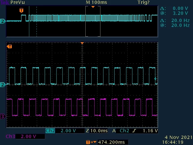

> What's the signal source, does it have clean edges?
The signal from the encoder looks good, clear transitions.0693W00000aHT3rQAG.jpg

waclawek.jan
February 23, 2023
> Here are the TIM registers.
And CR1?
Looks like you have CR1.OPM set.
