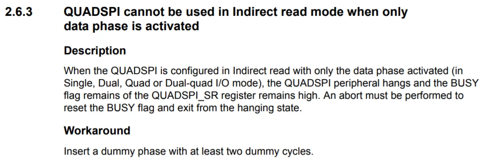

Andreas Bolsch
Andreas BolschBest answer
Lead III
Sep 25, 2019 6:43 AM UTC
Check errata sheet ES0392, Rev. 6, 2.6.3.

alexborysevych9
Sep 25, 2019 5:30 PM UTC
Wow! Thank you so much for 100% accurate answer! Now it is clear.
I will leave it here for the future:
