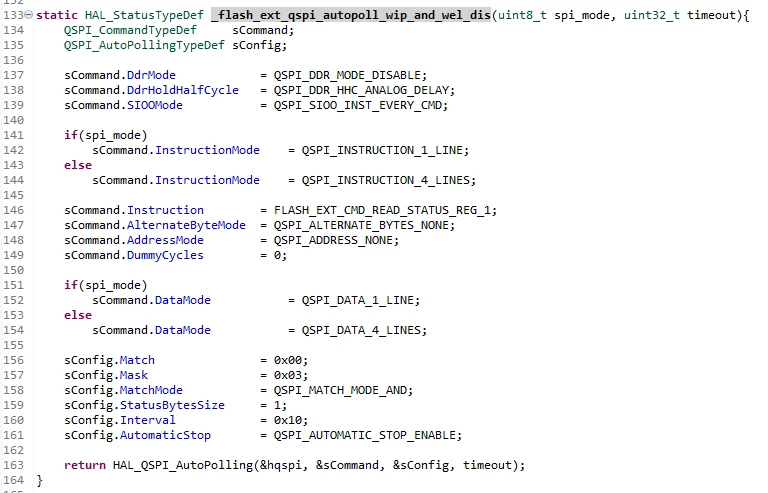

Make sure sCommand and sConfig are properly cleared, so they don't contain random/unpredictable junk.
 QSPI_CommandTypeDef   sCommand = {0};
 QSPI_AutoPollingTypeDef sConfig = {0};
Do you have a timeout?
Does it throw a timeout error? Does it throw a busy error, or some other failure/error code?
If the QSPI throws a timeout I'm pretty sure you need to use HAL_QSPI_Abort() to stop this, had at least one report, and my code walk scared me as none of the reference/demo code handles this.
Report hqspi.State and hqspi.ErrorCode

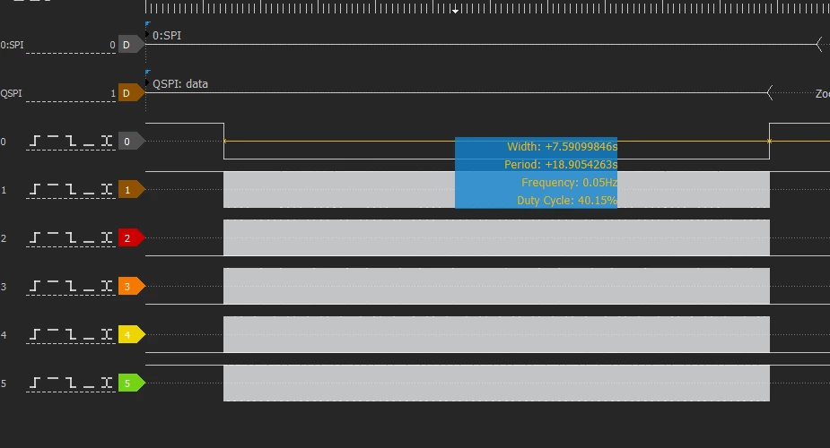

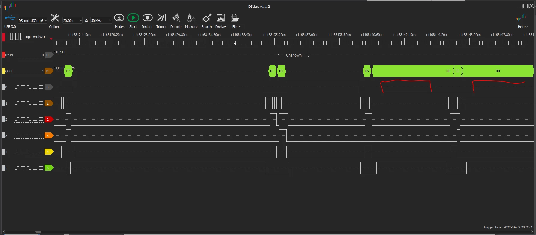

0693W00000LzPMrQAN.pngThe instruction elapse faster than the polling operation of qspi

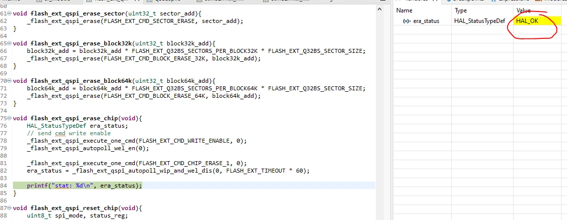

0693W00000LzPNuQAN.pngpolling operation take 7.1seconds but reach printf take less than 1 sec. Timeout is 60sec (FLASH_EXT_TIME_OUT 1000).
And I still doubting about cs not released after the first polling operation. There is not information related to this behavior in datasheet.

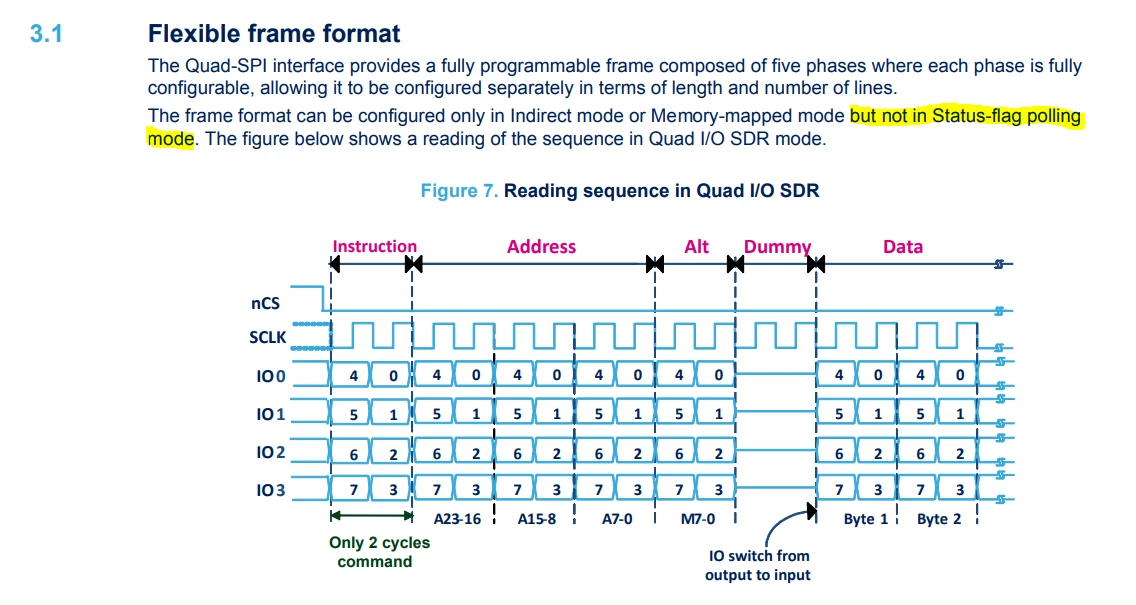

The red marked section (first post) is it retrying, should be able to modulate that width via sConfig/Interval
Why it's not matching is another matter, and may relate to structure initialization. It looks like the code is trying to match something else, or there is some disagreement about modes or patterns.

CLK period is 260ns, so interval is 16 cycles (0x10) which give 4.16us, and the logic analyzer match with this separation between lectures.
And also I initialize variables with zero, but the problem still occuring.

Now, hal_autoplling method wait correctly to the match value (7.1secs).
I change this two lines, from this:
sConfig.Match 	= 0x00;
sConfig.Mask 	= 0x01;
sConfig.StatusBytesSize = 1;
to this:
sConfig.Match 	= 0x0000;
sConfig.Mask 	= 0x0101;
sConfig.StatusBytesSize = 2;
Looks like, the minimum size for statusbytesize parameter is 2.

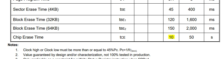

Weird for sure... pretty sure it should work with 1, you'd use 2 for a dual configuration, where you do want both die to complete, and the erase/write are self-timed, so one device is usually done ahead of the other. Full erase of parts can take minutes, definitely hundreds of seconds.

W25Q32JV-DTR indicate:
