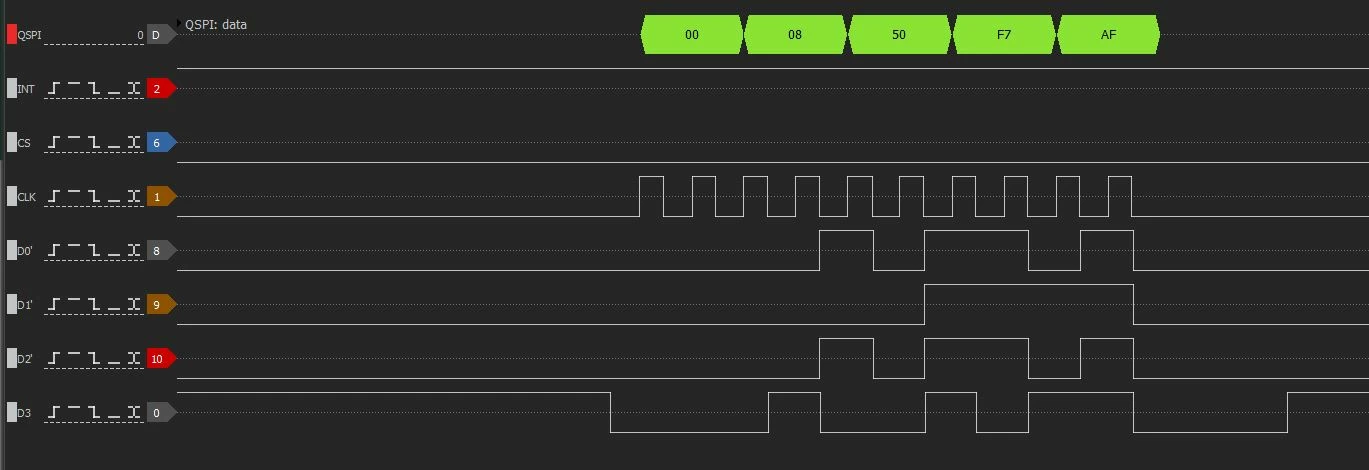

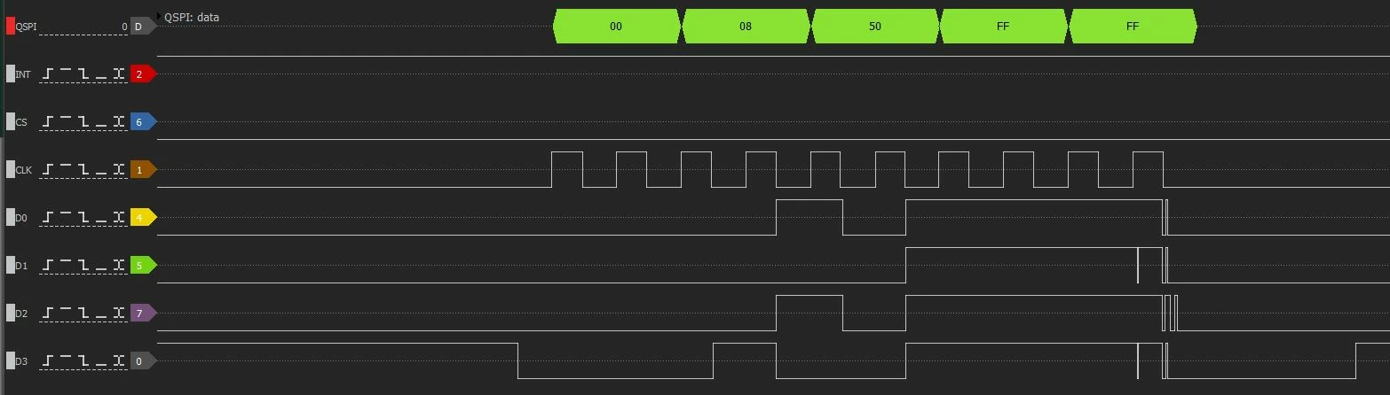

QSPI STM32F767xx reads wrong data
0693W00000WIe9vQAD.jpg0693W00000WIe9MQAT.jpgUsing STM32F767xx as QSPI master and Cortex M33 as a slave
While reading the header (4 bytes) i see the first 2 bytes are correct always and the last 2 bytes as 0xFF's. If i take a capture directly from the QSPI pins on the slave i see correct values but as soon as i connect STM and capture on the STM QSPI lines it's all wrong.

Attached both valid and invalid captures for reference

Hello @Arnab​,
I recommend you verifying if the QUADSPI peripheral enters memory-mapped mode with bits ADDRESS[1:0] of the QUADSPI_AR register both set; it might cause a wrong data from memory-mapped read after an indirect mode operation

A lot of examples has sCommand as a local/auto variable, I'd recommend clearing that so the structure has predictable content, not random stuff from the stack, as the HAL pulls and combines bits from multiple fields to construct the QSPI register settings.
Using the assert() methods to pin point parameter issues can also be useful in catching / containing odd behaviour.
