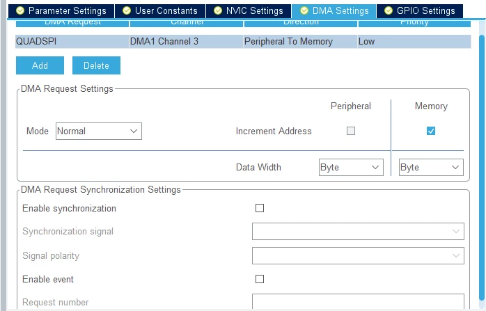

I have DMA enabled in the Device Configuration Tool (DMA1 Channel 3, Peripheral to Memory, low priority, normal mode, synchronization and event disabled) with the QUADSPI global interrupt enabled, priority 5.

All I did to enable interrupts was check the QUADSPI global interrupt box in the device configuration tool. I believe that's all that was required for other peripherals using DMA.
Also, these lines are created in the NVIC initialization code:
 HAL_NVIC_SetPriority(DMA1_Channel3_IRQn, 5, 0);
 HAL_NVIC_EnableIRQ(DMA1_Channel3_IRQn);
Importantly, I've found that if I change the priority of 5 to anything less, then HAL_DMA_IRQHandler does get called.
