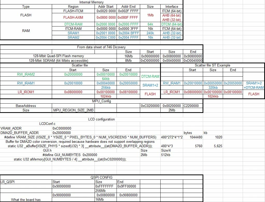

Hello all,
I try to make my own example based on AN4760 and QSPI_perfs example from STM32Cube_FW_F7_V1.8.0.
The MPU init code is:

in GUIConf i have the LCD memory set as
&sharpdefine GUI_NUMBYTES  0x200000
static U32 aMemory[GUI_NUMBYTES / 4] __attribute__((at(0xC0200000)));
In LCD LCDConf.c i have
// Video RAM Address
&sharpdefine VRAM_ADDR 0xC0000000
// DMA2D Buffer Address
&sharpdefine DMA2D_BUFFER_ADDR 0x20000000
my scatter file

My understanding from '4.1.2 Programming QSPI Flash memory using IDE' is that i dont have to use STM32 ST-LINK utility if i respect the steps from this chapter.
However when i upload to the F746 dicovery no data is placed in
0x9...... area.
So may questions are:
Is there some extra step the i need to do in order to use the QSPI from the IDE?
Does the LCD configuration has any influence of the QSPI? (i do not think so, see attached image)
Should i insert in the scatter file also the external SDRAM?
Where
 can i find a tutorial with examples for the scatter files?
For the MPU config, should i switch to the configuration presented here?
http://www.keil.com/support/docs/3777.htm
Thank you.
