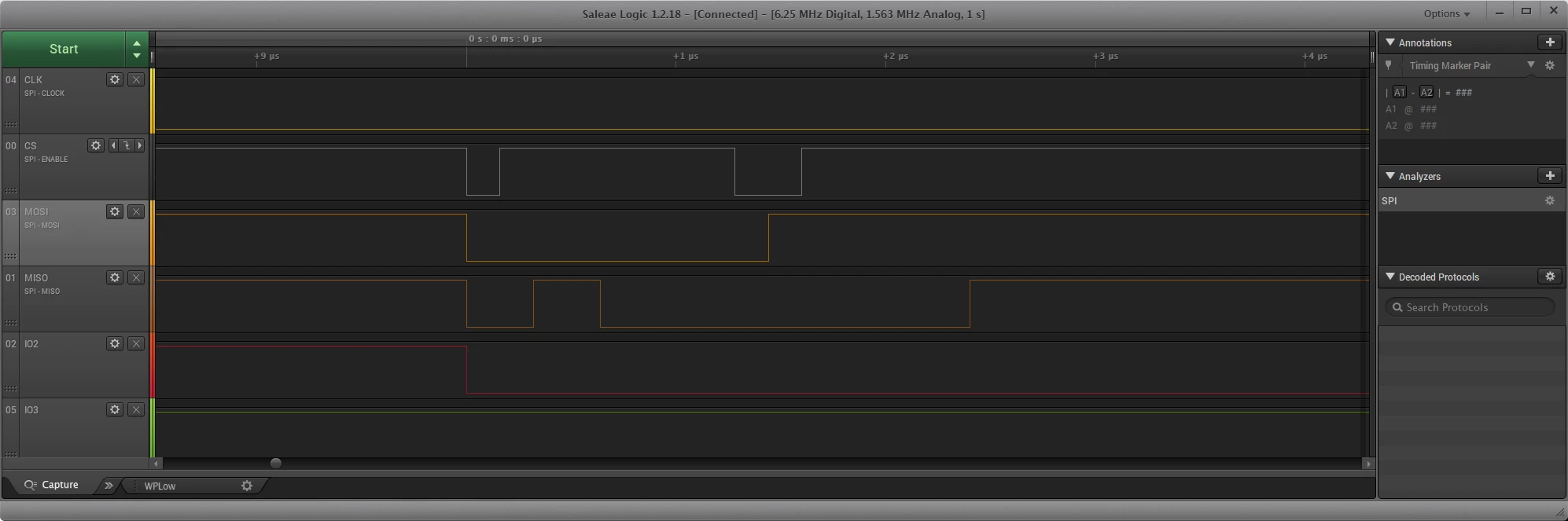

Ok, now i'm really confused. Connected up my Saleae logic analyzer to the flash chip and two things immediately stand out to me:
  1. I don't see the CLK toggling. I don't know how the other signals are showing negative edges at the same time without a clock. I've checked my wire lead to the flash and looks well soldered... but the code seems to be calling the functions to enable the QSPI clock in the HAL_QSPI_MspInit, so clock should be running.
  2. IO2, which is active low Write Protect, goes low and stays low. So I can see how it is getting stuck in QSPI_WriteEnable(hspi). IO2 and IO3 both have 10K pull-ups externally connected to them.
Since MX_QUADSPI_Init runs without hitting the Error_Handler(), I'm expecting my QSPI clock to be running from that point. Is this an incorrect assumption?

If I change:
if (HAL_QSPI_Command(hqspi, &sCommand, HAL_QPSI_TIMEOUT_DEFAULT_VALUE) != HAL_OK)
if (HAL_QSPI_AutoPolling(hqspi, &sCommand, &sConfig, HAL_QPSI_TIMEOUT_DEFAULT_VALUE) != HAL_OK)
to
if (HAL_QSPI_Command(&hqspi, &sCommand, HAL_QPSI_TIMEOUT_DEFAULT_VALUE) != HAL_OK)
if (HAL_QSPI_AutoPolling(&hqspi, &sCommand, &sConfig, HAL_QPSI_TIMEOUT_DEFAULT_VALUE) != HAL_OK)
It doesn't wait 5 seconds to timeout, it fails sooner (HAL_QSPI_Command only fails when using &hqspi and not hqspi). And I really thought that was the problem. I'm pretty sure it needs the ampersand. Right?
bitlischieber
September 19, 2019
I just had a similar issue.
At last i discovered, that the defines for my QSPI pins where defined wrong in a header file.
