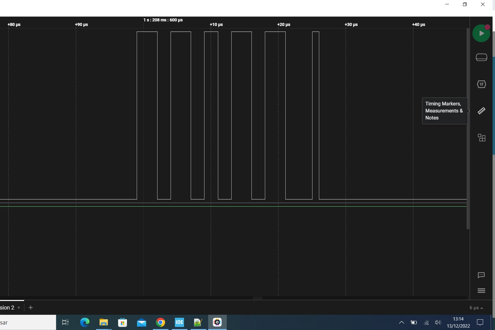

pwm ws2812 not workin

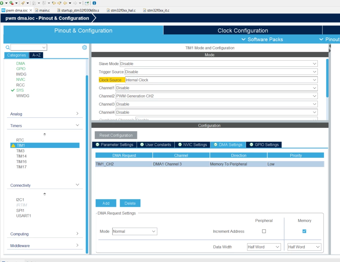

Hi! i am doing example pwm ws2812 with dma, configure the time 1 with ARR=60, using clock= 48 mhz, my pwm not working full buffer i don´t know why not work full buffer, the pwm have 12 pulse, i am sending for one led ws2812 is 24 pulse.

why not use spi for this ?

thanks, i make your tutorial and this funcional. my bluepill is funcinal too. i know your is using timer 1, this is in APB2 bus, and i am using timer3 this is in APB1, the clock is different.

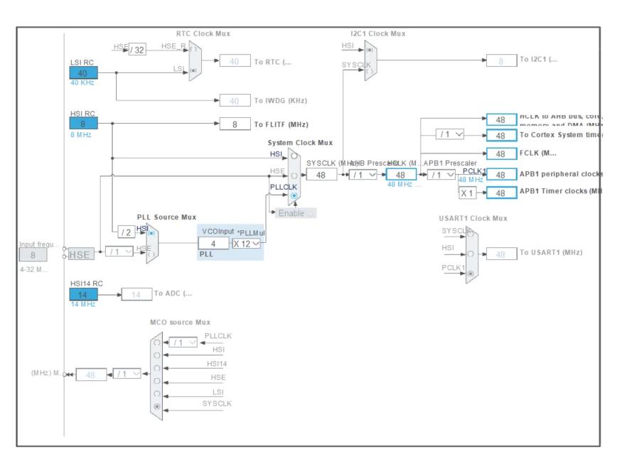

HI! THANKS! I GOING TO USE YOUR TUTORIAL, I HAVE A QUESTION, I HAVE A CUSTOM PCB WITH STM32F030K6T6, BUT I NOT HAVE CRYSTAL EXTERN, I AM USING INTERNAL 48 MHZ, THIS INFLUENCY IN THE PWM? MY BLUEPILL IS FALSE IN THE ALIEXPRESS, I BUY BLUEPILL AND NOT WORK.

0693W00000WL0sNQAT.gif>>I AM USING INTERNAL 48 MHZ, THIS INFLUENCY IN THE PWM?
YES, IT WILL MAKE YOUR SYSTEM CLOCK LESS ACCURATE AND PRONE TO DRIFT WITH TEMPERATURE, BUT NEOPIXELS TOLERATE A BIT OF PWM DRIFT, CHECK IT OUT YOURSELF.

Ah ah ah ah ah! thanks! i don´t know why my pwm stop, not work one moment and work other moment.
