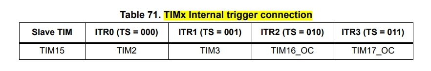

Hello @MM..1,
Your idea is valid, you can use 2 timers, one for generating the PWM signal and another for managing the sample time and frequency, however, TIM16 and TIM3 cannot be linked by configuring the master/slave mode, there are no internal connection between these 2 timers
check TIMx internal trigger connection in your product RM:
