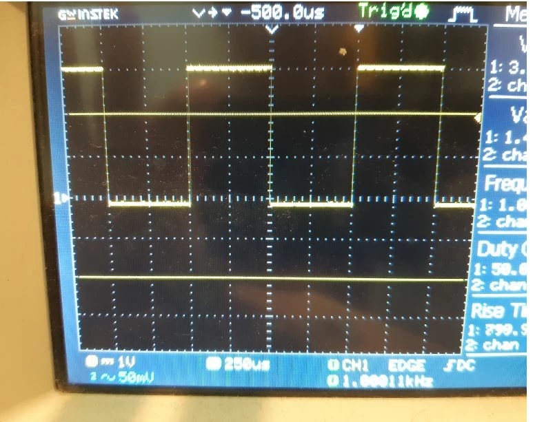

Here is code:
Prescale=7;Periode=7999;Pulse=3998;
void PWMControl(unsigned int Freq){
TIM_TimeBaseInitTypeDef TimeStructureure;
TIM_OCInitTypeDef TIMOCStructureure;
 TimeStructure.TIM_Prescaler=Prescale;
 TimeStructure.TIM_CounterMode=TIM_CounterMode_Up;
 TimeStructure.TIM_Period=Period;
 TimeStructure.TIM_ClockDivision=TIM_CKD_DIV1;
 TimeStructure.TIM_RepetitionCounter=0;
 TIM_TimeBaseInit(TIM4, &TimeStructure);
 TIM_Cmd(TIM4, ENABLE);
 TIMOCStructure.TIM_OCMode=TIM_OCMode_PWM2;
 TIMOCStructure.TIM_OutputState=TIM_OutputState_Enable;
 TIMOCStructure.TIM_OCPolarity=TIM_OCPolarity_Low;
 TIMOCStructure.TIM_Pulse=Pulse;
 TIM_OC1Init(TIM4, &TIMOCStructure);
 //TIM_OC1PreloadConfig(TIM4, TIM_OCPreload_Enable);
 TIM_ITConfig(TIM4,TIM_IT_Update,ENABLE);
void TIM4_IRQHandler(){
 if (TIM_GetITStatus(TIM4, TIM_IT_Update) != RESET)
 X=X+1;
 TIM_Cmd(TIM4, DISABLE);
 TIM_ClearITPendingBit(TIM4, TIM_IT_Update);
The above code generates a 1Khz with 50% duty cycle with interrupt. However, by counting the X variable(TIM4_IRQHandler) each second I should have 1000 pulses but I get 100 pulses each second. I am curious to know what my problem is.

waclawek.jan
Jan 20, 2021 12:55 PM UTC
Try to toggle a pin in the IRQHandler and observe together with the PWM pin on oscilloscope/logic analyzer.

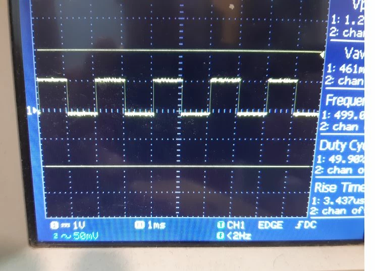

JJohn.3
JJohn.3Author
Jan 20, 2021 6:38 PM UTC
Thank you very much for your comment.
I changed my program to
			if(X!=1){
					X=1;
					GPIO_SetBits(GPIOE,GPIO_Pin_13);
			}else
					X=0;
					GPIO_ResetBits(GPIOE,GPIO_Pin_13);
					//TIM_Cmd(TIM4, ENABLE);
and Here is my output:
0693W000007C47mQAC.jpgand Here is my PWM output
0693W000007C47wQAC.jpg They are the same( my PWM takes 1ms to make a Pulse , and my IRQ Toggle the output at 1ms,Am I right?) my variable is long volatile but it takes the wrong value.

JJohn.3
JJohn.3Author
Feb 2, 2021 10:32 AM UTC
Thank you very much , it was related to showing the X variable.
