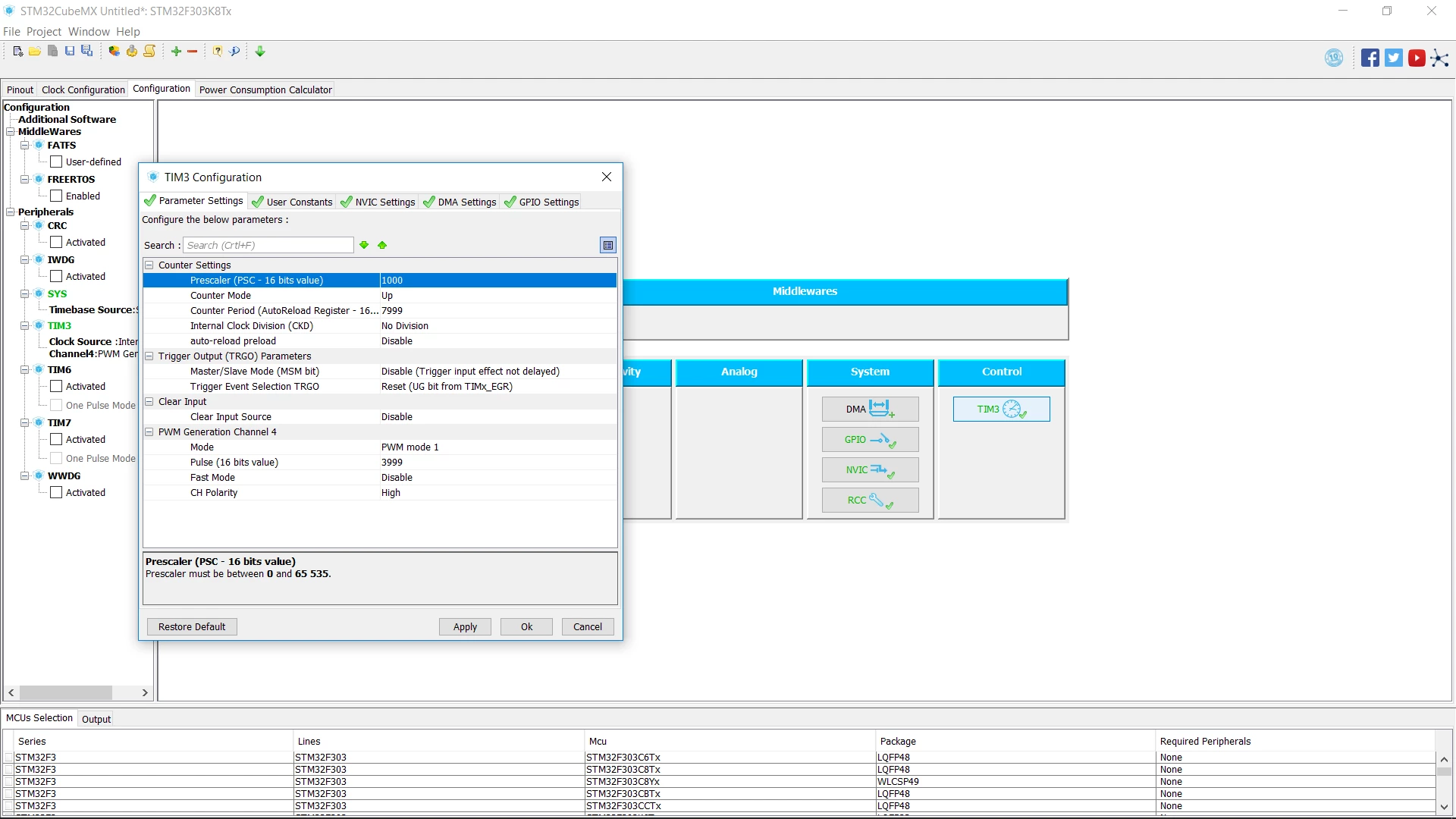

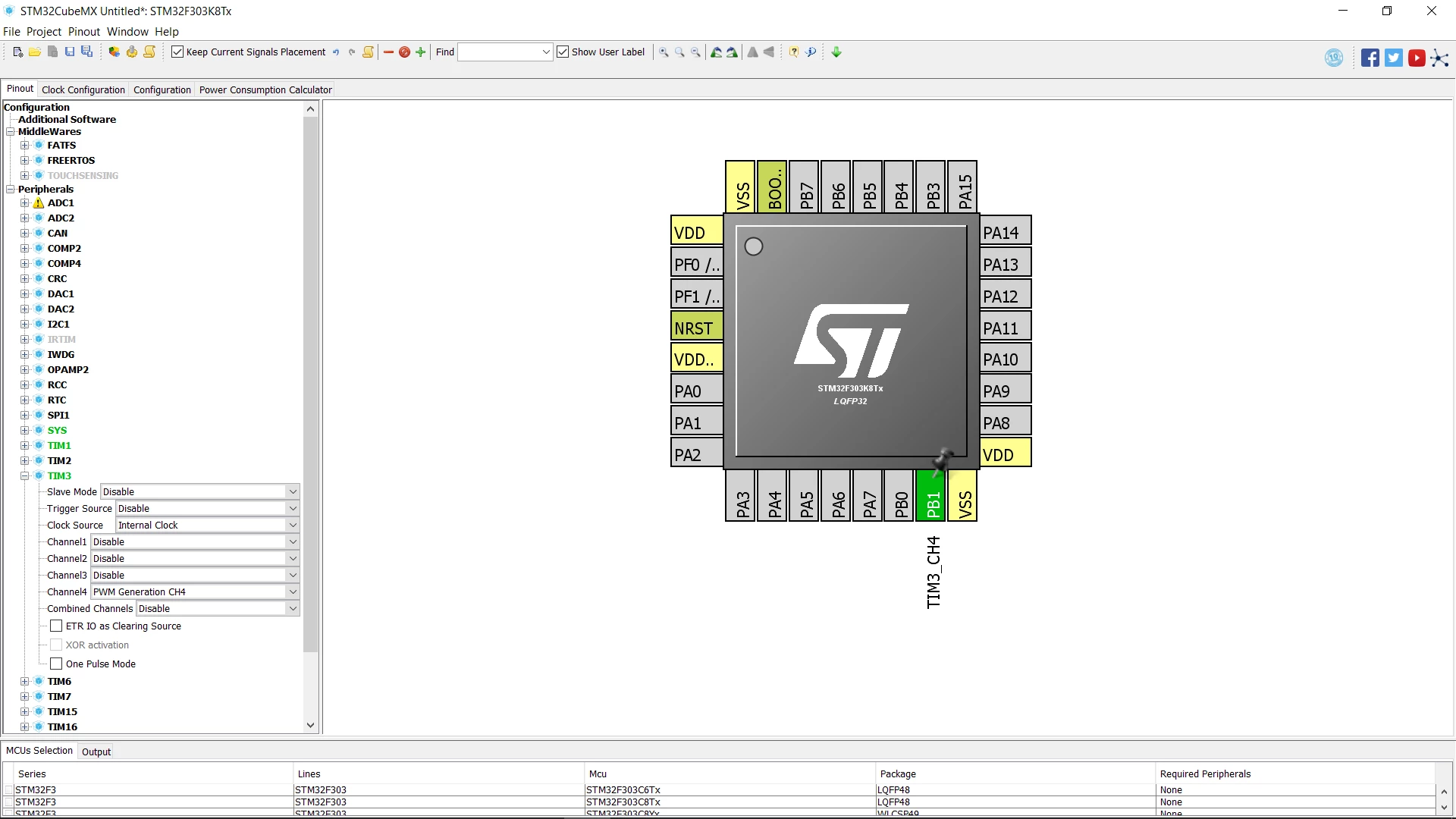

    Ali Yazdanifar
    Jul 5, 2018 2:26 PM UTC
    Posted on July 05, 2018 at 16:26
    Hi, you can do this work in this way: in the stm32cubeMX you set this settings :
    you can set your duty cycle and other settings in this way :
     with this settings , we have 50% duty cycle with 1Hz frequency . after generating your project :
    you can start your pwm in this way :
    HAL_TIM_PWM_Start(&htim3, TIM_CHANNEL_4);
    <write this on top of while(1) >
    you can change your duty cycle with
    __HAL_TIM_SET_COMPARE(&htim3,TIM_CHANNEL_4,3999);
    its all thing that you should do .
