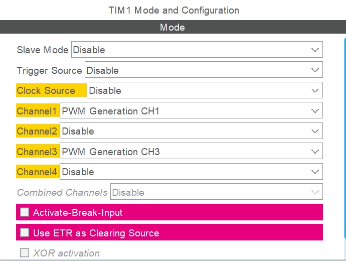

Hello every body.
MCU:STM32F103RBT6 LQFP-64 Package
PWM Capture in on PA6(TIM3-CH1)
The PWM Capture signal source is Frequence is 50KHZ to 1.0MHZ,
Duty cycle and Frequence always change by loading switch.
PWM Out Function on foue output are:
PA8(TIM1-CH1) PA10(TIM1-CH3) & PB8(TIM4-CH3) PB10(TIM2-CH3)
My Question as below.
Question 1:
I can capture in PA6(TIM3-CH1) Duty cycle and Frequence is okay(TIM3-CH1 detect rise edge,TIM3-CH2 detect falling edge,and I used the Interrupt capture in the signal, and used the PA6(TIM3-CH1) master trigger(TRGI) to another PWM out as PA8(TIM1-CH1) PA10(TIM1-CH3) & PB8(TIM4-CH3) PB10(TIM2-CH3), The foue output trigger by ITR2(TIM3)-TRGI used the TI1FI1 or TI1F_ED.
How can i do the four output PA8(TIM1-CH1) PA10(TIM1-CH3) & PB8(TIM4-CH3) PB10(TIM2-CH3), follow the PA6(TIM3-CH1)’s Duty cycle and Frequence?
I mean as same as PA6(TIM3-CH1) ’s Duty cycle and Frequence on foue output.
Now my programe can follow the Duty cycle Frequence,but the duty’s polarity is wrong.(It used ITR2(TIM3)-TRGI is TI1F_ED. The wrong polarity is random.
If used TI1FI1 by ITR2(TIM3), The four output duty cycle is gone. And Frequence is Half Speed.
Question 2:
If Question 1 can get resolved.
My other question is three output PA10(TIM1-CH3) & PB8(TIM4-CH3) PB10(TIM2-CH3),How to Shift the Phase? But Duty cycle and Frequence still as same as PA6(TIM3-CH1).
