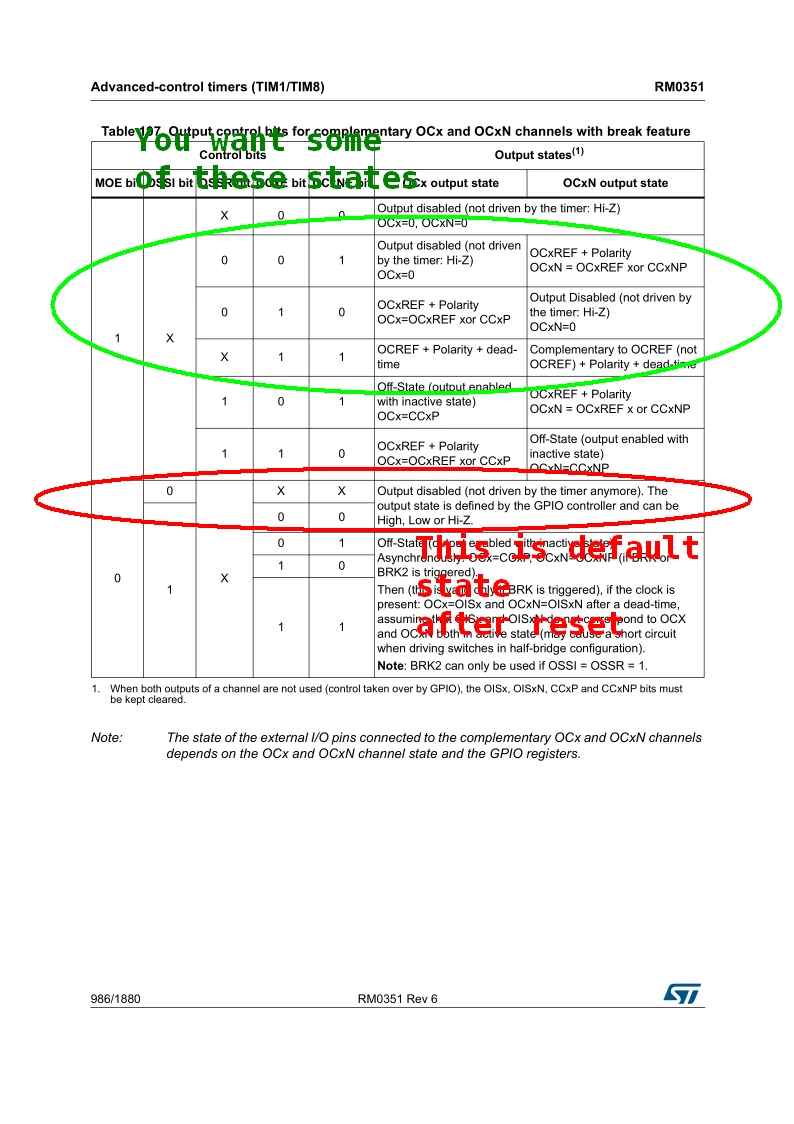

waclawek.jan
November 1, 2019
Read out and post content of relevant GPIO and TIM registers.
TIM1 is Advanced timer, did you set TIMx_BDTR.MOE?
I don't Cube.
Tesla DeLorean
Guru
November 1, 2019
You enable the peripheral clock somewhere?
rickard2
rickard2Author
November 2, 2019
Port A peripheral clock is enabled in other code yes.
Can you clarify TIMx_BDTR.MOE?
waclawek.jan
November 2, 2019
I was lazy to locate the RM for your particular chip, but the timers are much the same.
